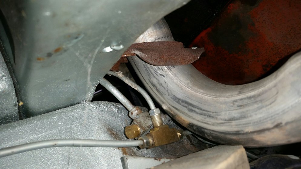

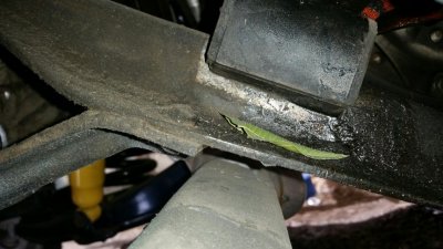

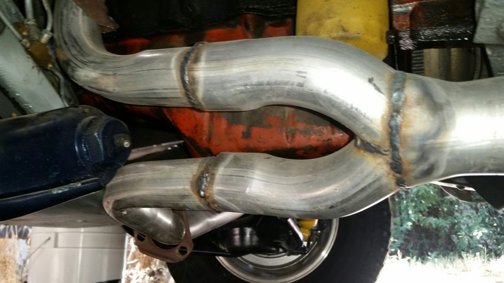

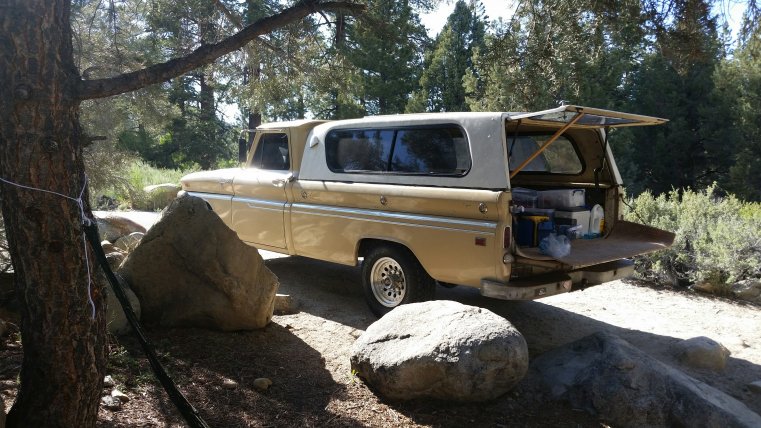

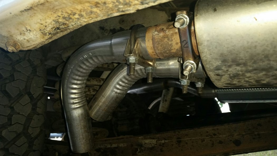

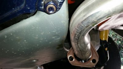

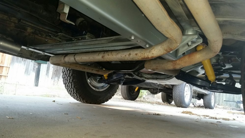

Just finished up a trip with the truck that clocked about 1,300 miles and the truck did great. Camped 4 nights, and was able get some of my sanity back by breathing cool-clean-mountain-air. The current engine is definitely underpowered for some grades, but it ran well and kept up with traffic doing 70. It fought me tooth and nail to get it finished for the trip and the departure date was postponed a day because of that. Part of the fight was the temporary exhaust sytem. Got it installed, bolted the right rear tire back on and the pipe hit the tire. The D60 must be a tad wider than the HO70 that is currently in this truck. With the temp-exhaust installed I at least fired up the truck to hear it. It ran smooth. Shut it down right away so I didn't burn my new tire. So I ventured over to an auto parts store and got some exhaust elbows to divert the heat away from the RR tire. It worked, but it is ugly. And it made the truck much louder than it was with the pipes exiting behind the tire. The new stupid exhaust system, had to cut it in two places to get the front portion removed. I swear that guy that did this new system is either a moron or very inexperienced. One-The exhaust system was not at all able to be removed because it hit the lower suspension control arms. Two-He cut my bell housing mount cross member and hammered the pipe flat on the top side to get it to clear the cross member instead of utilizing the factory high spot of the cross member to run the exhaust pipe under. Three-As I mentioned before, the pipe from the passenger side is way too close to the brake lines and front cross member. Four-He used pipe bigger than 2 inch for the pipe mounting to the exhaust manifolds. I told them I wanted 2 inch from the manifolds and 2.5 inch from where the 2 inch came together and out past the axle with 2.5 inch.
The new system isn't as close to the brake fittings and cross member when bolted up, but the clearance is maybe 1/4 inch more at the fittings, and maybe 1/2 inch more at the front cross member than what the photos show. Still way too close for my liking. If this truck was a trailer queen it wouldn't matter.
I didn't get any pics of the temporary fix for the exhaust exit, I will get that tonight after I get the camper taken off of it.

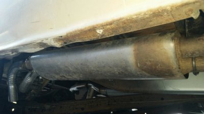

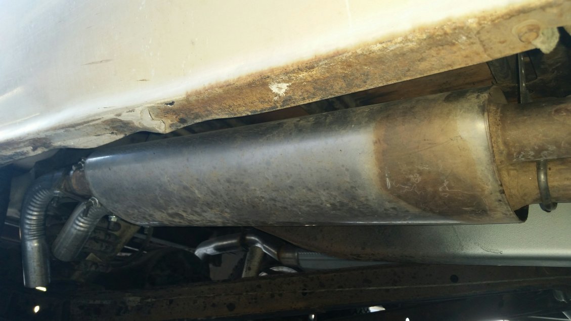

Here is the ugly fix so I could go camping. It is still close to the tire, but it never got too hot. Saturday I need to get it back to the shop for them to fix their screw-up. I will be staying put this time so I can keep an eye on what they're doing. Last time I went to work for a few hours and ended up with a crappy system. It looks nice, and is quieter, but it makes me angry that they call themselves exhaust specialists and can't produce a good working exhaust system. Hopefully round 2 will be successful.
The temporary exhaust has an old Borla muffler, dual in/dual out, and it sounds really nice. To be quite honest I am conflicted on whether the shop can redo the y-pipe correctly, so I am debating just having them run a single 2.5 inch from the Borla muffler out past the right rear tire, with a resonator to quiet it down a tad.

yeah, I don't like that exhaust system much.

Yesterday I made the final decision on the exhaust. I don't trust that they can successfully redo the y-pipe off the manifolds, so I will be removing their new system and will be keeping the old system in place, but will have them do small y-pipe off the dual exit borla muffler and run 2.5 inch single out the back. Then I'll find some resonators and add those in just off the manifolds of the old exhaust to get rid of the loud drone inside the cab. I can add that new muffler to the exhaust in the '81 to quiet it down a tad.

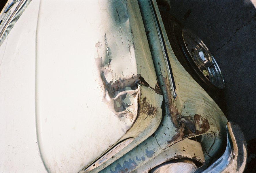

I have mentioned my old truck Mean Green a few times in this thread. Last night I finally fired up the home computer and I dug around for some old photos of the beast truck called Mean Green. Unfortunately these are of the crunched version. Heartbreaking to see them. But, seatbelts do work! And I am glad I had them installed.

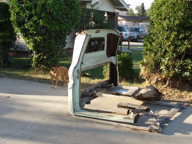

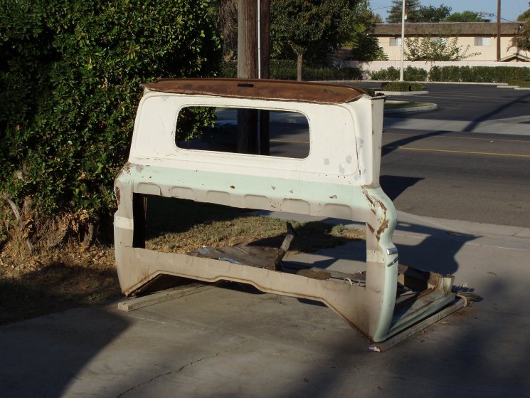

This is all that was left that was hauled off to scrap. If I knew then what I know now, I would have kept it all. But I got some chunks of good metal from it and the rest of the truck is still with me too. Good old Sybil, damn good dog right there. She is not doing well now, 14 and a half and her body is breaking down. In that photo it looks like she is wondering what happened to the truck she grew up in.

Well, I couldn't bring myself to trust the exhaust shop to fix their work. Not the y-pipe off the manifolds as mentioned, but also the alternate method I was going to have them do. I found another shop with great reviews, a one-man show. Good guy. I stopped in during lunch on Friday, told him my plan, walked back to work, and in about two hours he called me back that is was done. On my afternoon break I walked to get it, and for just over $100 it is much better. Instead of running the old loud system with resonators, I opted to have this guy tie-in to the remainder of the new system I left in place. I went that route because I figured it would be much quieter than the other setup even with resonators upstream from the muffler. Can barely hear it now and that is exactly what I wanted. Even before this work was done, the new system wasn't this quiet. Not sure why, but it was still audible, not like it is now, nice and quiet. It's a pleasure to drive and be able to hear yourself think, and only hear the transmission gears whining. Of course it comes with a price, now the various rattles shine through, so I have to quiet those down. Lots of bed bolts to tighten, and need some new weatherstripping for the doors. That should help a bunch. I meant to get under the truck this weekend to see what the guy did, but I got sidetracked with chores and never worked on the truck. When I get under there I'll snap some shots of his work. He did use the old pipes off the manifolds and ran new from those. Will be using him for any exhaust work in the future.
