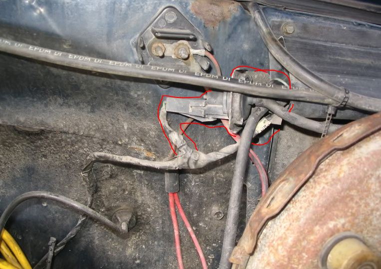

I'm ready to drop motor back in and redo electrical.
Just want to make sure.. this switch/vacuum port is for lockup transmission??

Yup

yes Im pressure sure that's for your transmission vacuum, do you have a 700r4?

The same switch was used for both.
TH350 only requires vacuum off the manifold not an object such as this. The TH350C uses a different setup which uses a connector on the left side of the transmission.
OP has a TH350 so this is not required.

I just got rid of a th350c and the lock up connector is in the same side... same vac switch I seen in the yards. Guess they could be different somewhere.
TH350Cs are a rare breed unlike the TH350

I would leave it in place. You never know what time may throw at you:) Just tie the wiring up neatly under the frame at the transmission.
I am looking for the pig tail that connects to the TCC switch.
