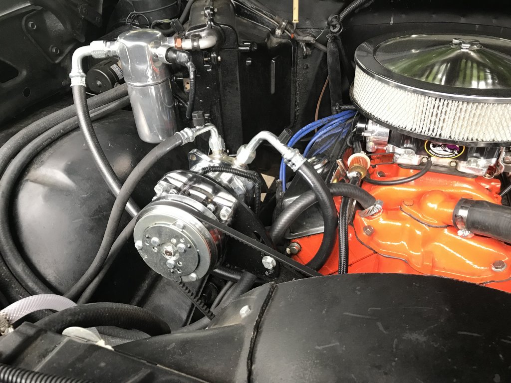

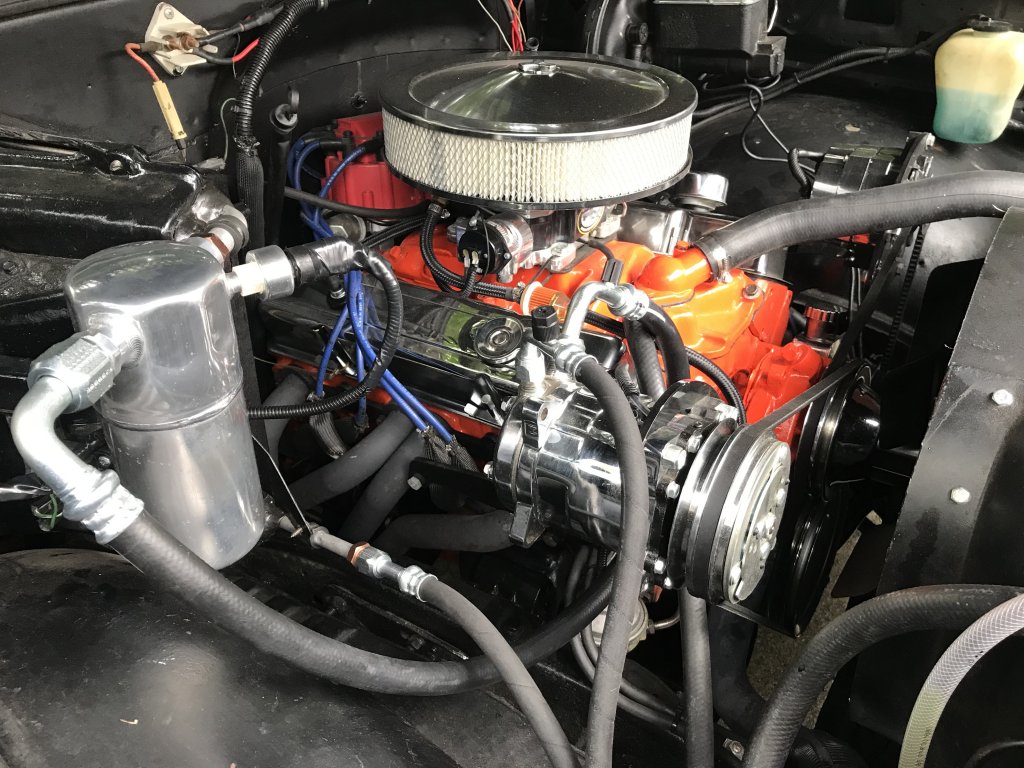

I was faced with the same dilemma. Chose to replace everything. Bought the larges condensor I could find, replaced evaporator and compressor with sandon style. Had all new hoses made. Best thing I’ve done yet. 1973 GMC
