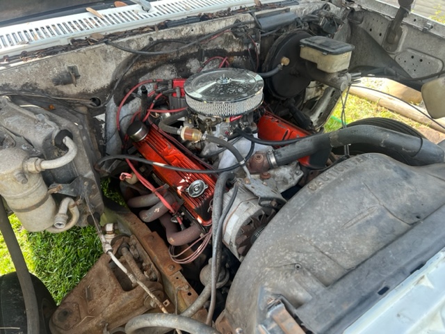

Barrett-FL
Nov 5, 2023
17
Central Florida
Barrett
86
Thank you all for your replies!
The carbonator and intake manifold are Edelbrock.
I was thinking of having the electric fuel pump as a primer as Copymutt suggested.

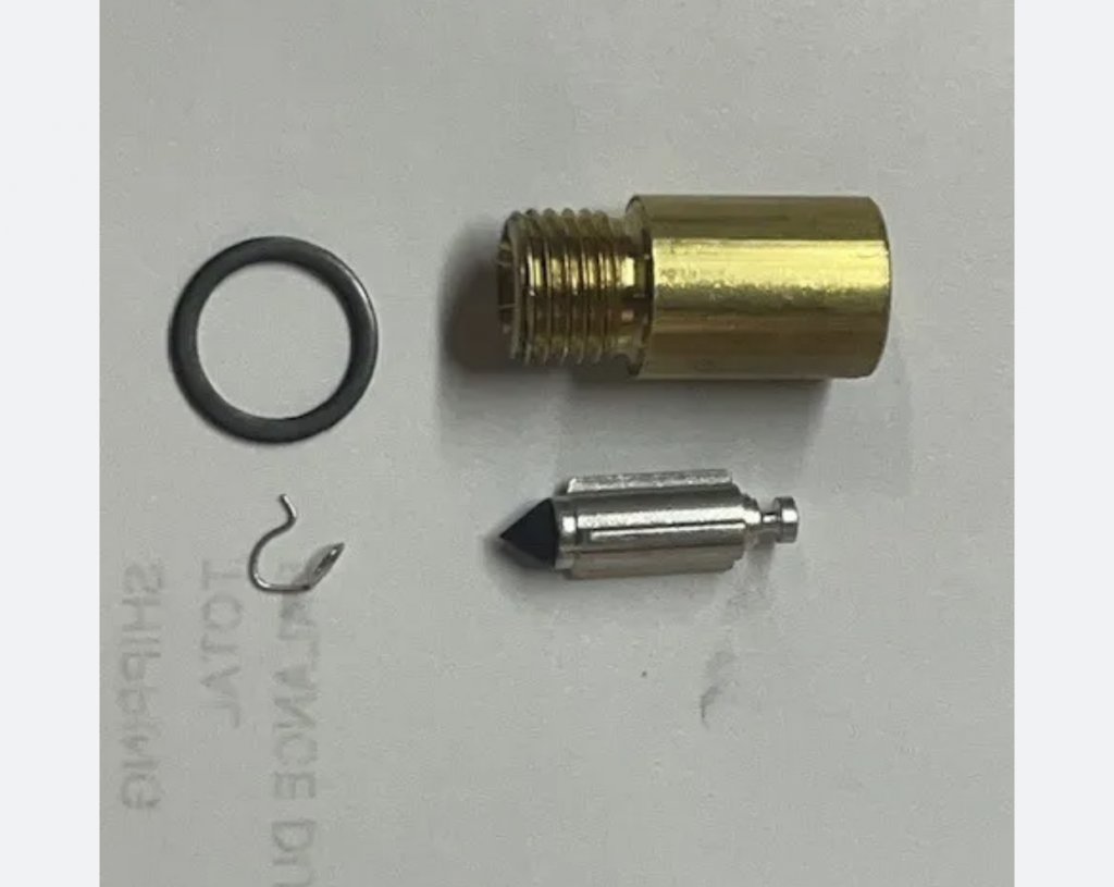

Not sure what a "widowed Needle" is.
Matt69olds
Jan 8, 2018
2,389
3,688
Central Indiana
Matt
GMC 1/2 ton
455 Olds

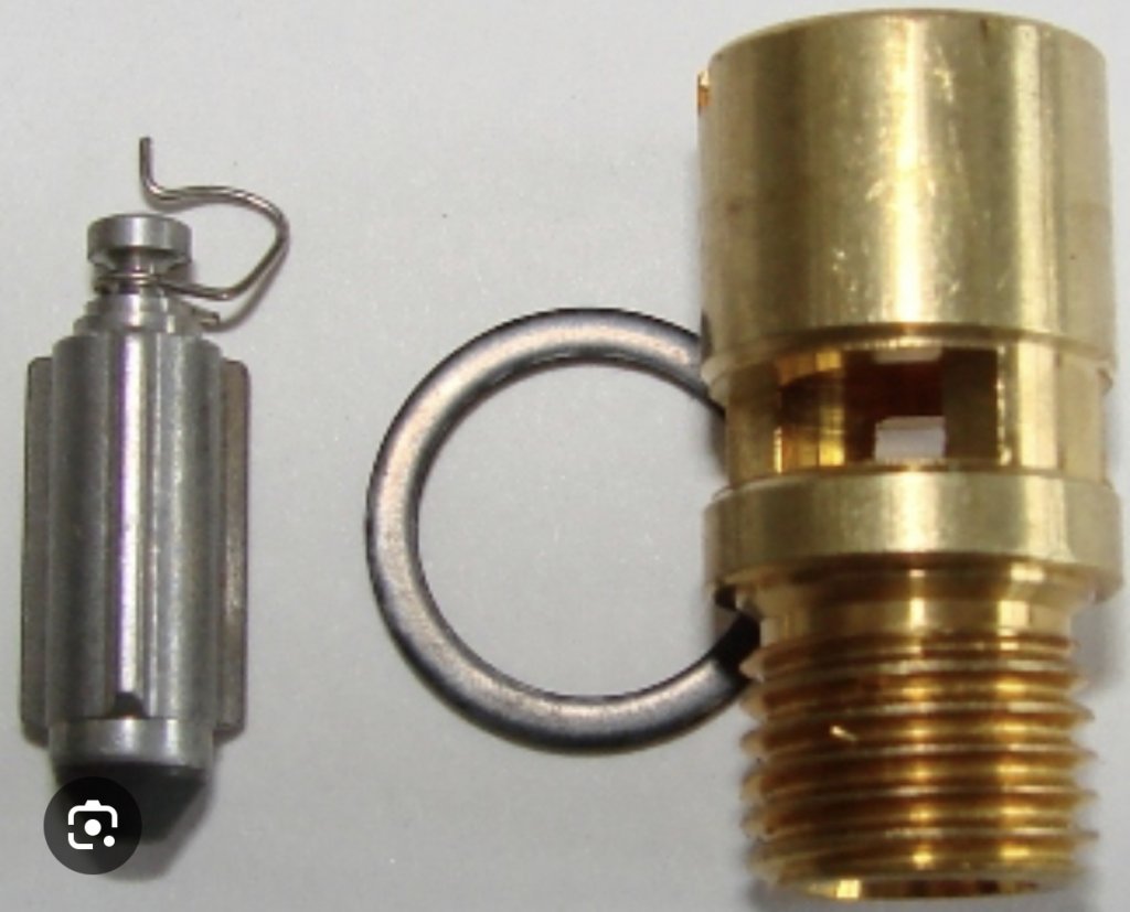

Windowed style on the left, solid on the right.
