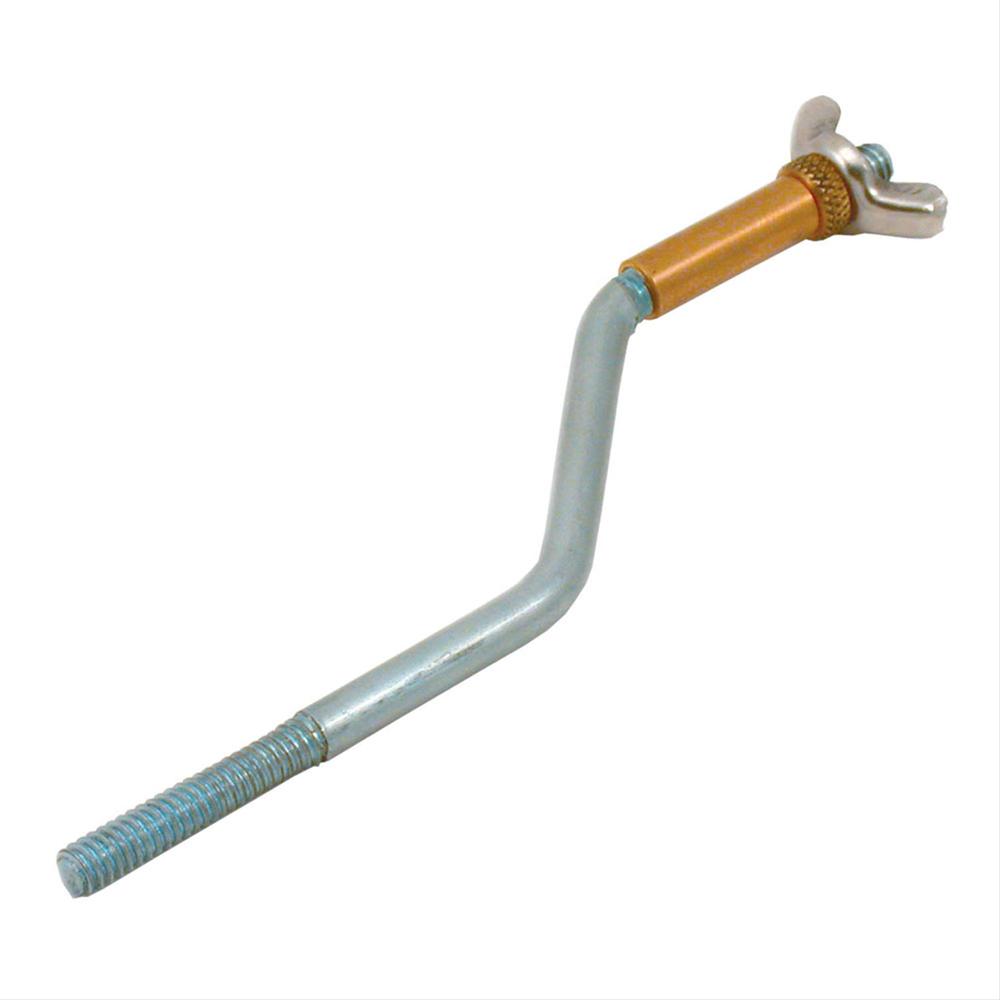

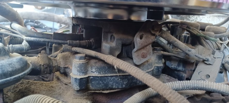

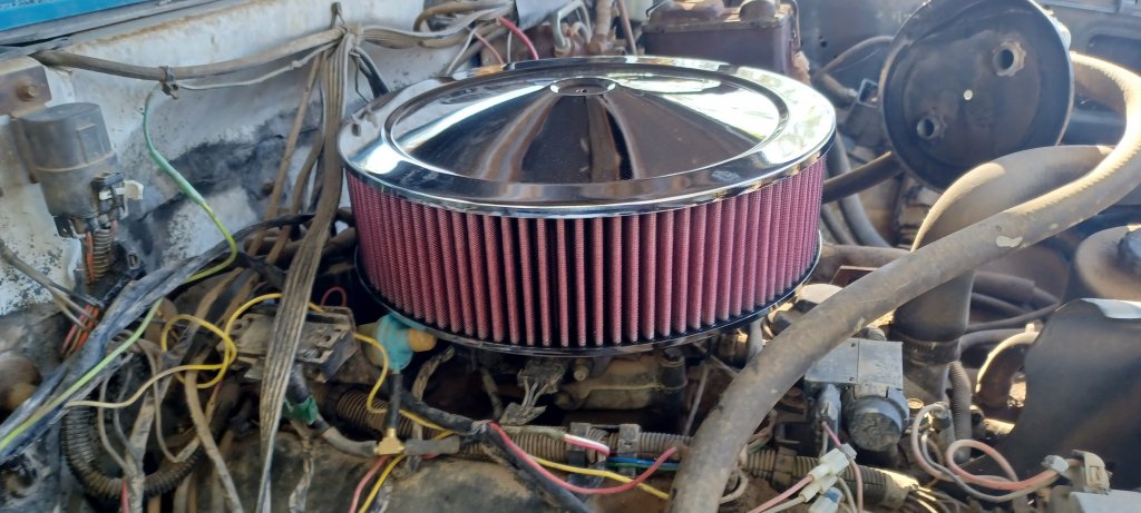

This air cleaner is a perfect fit for an '89 454 SM 465 man trans w/tbi. No clearance issues at all. I believe most any flat base style 14 inch air cleaner with a 5 1/8 or 5.125inch flange would work. I don't think a 5 inch tall filter would fit without hitting the hood. Don't forget to R/R the air cleaner stud with an off set one. Part numbers below are what I used, but this is not an endorsement for any brand and is for informational purposes.
