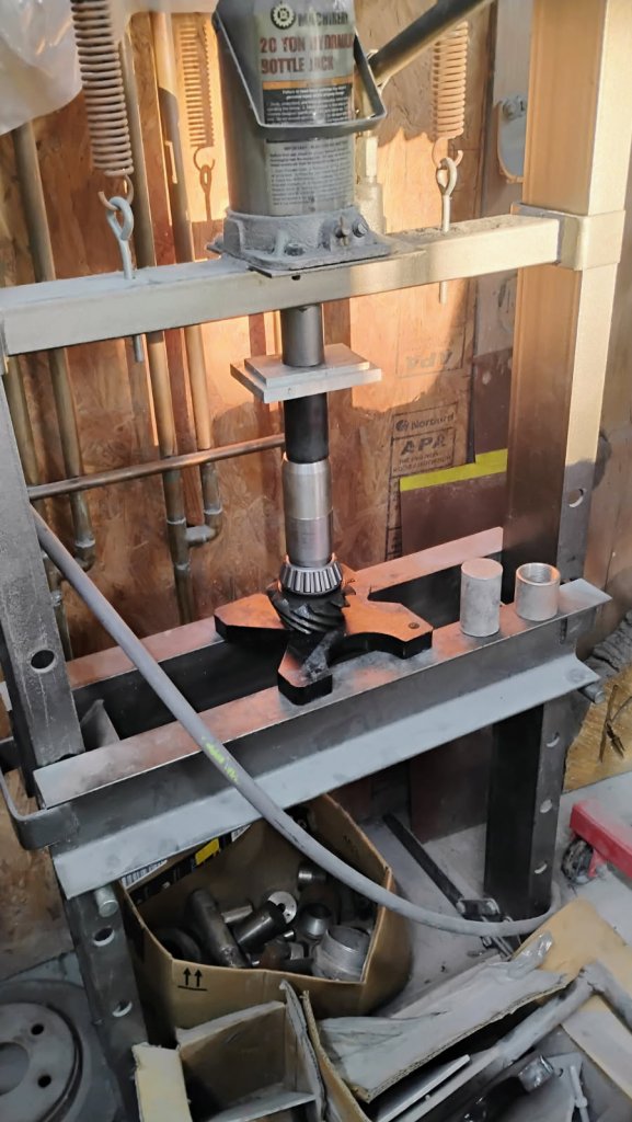

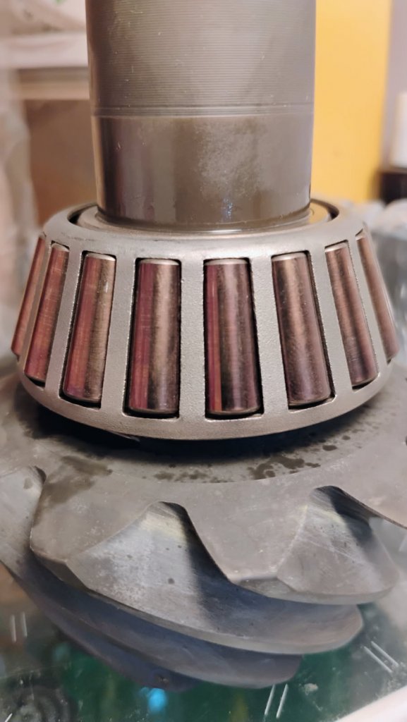

Did I ruin this pinion bearing?

For press and interference fits I like to slick the surfaces up with some high pressure lube, just a real light film coating. I use the J&S stuff, but the CMD product is good too. You can really feel a difference with and without using it.

I’m too late but wanted to tell you to put it in with the burner bearing just to check depth so when you go to put on another bearing you can change the shim if required.

This is what I did with mine. I ordered two bearings and took a Dremel to the inside circumference of one of them and made a setup bearing. Glad I did because I had that pinion in and out about 100 times before I got it right.

Thanks, I did buy a set-up bearing from the vendor. Now I have two,ha.
