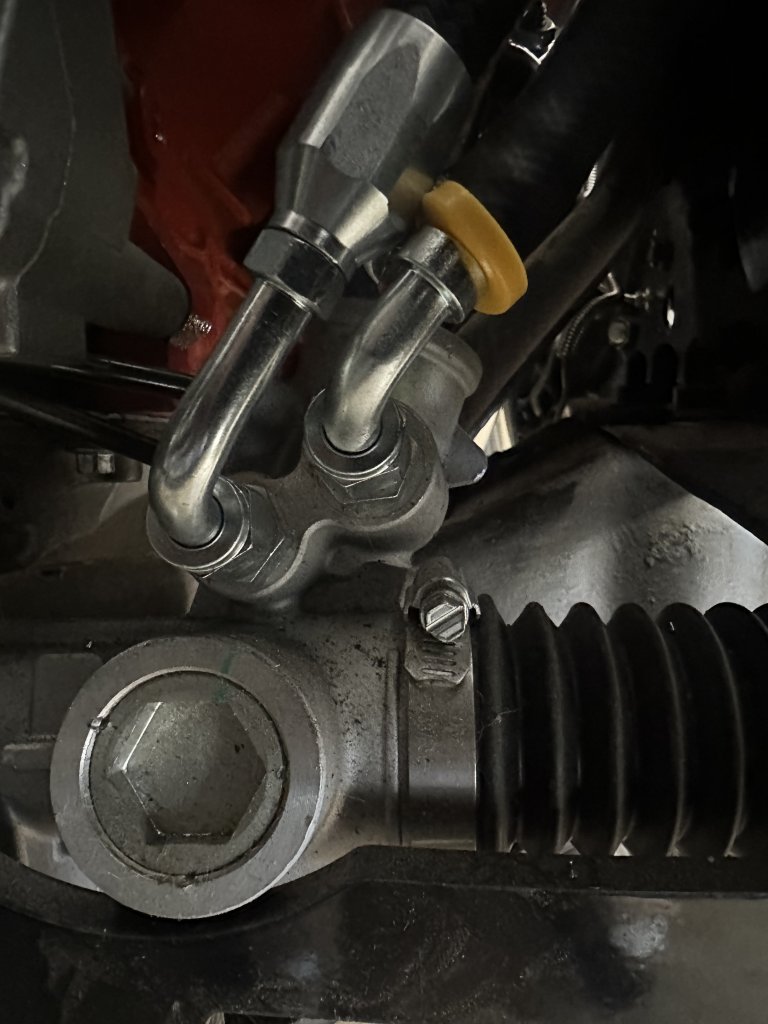

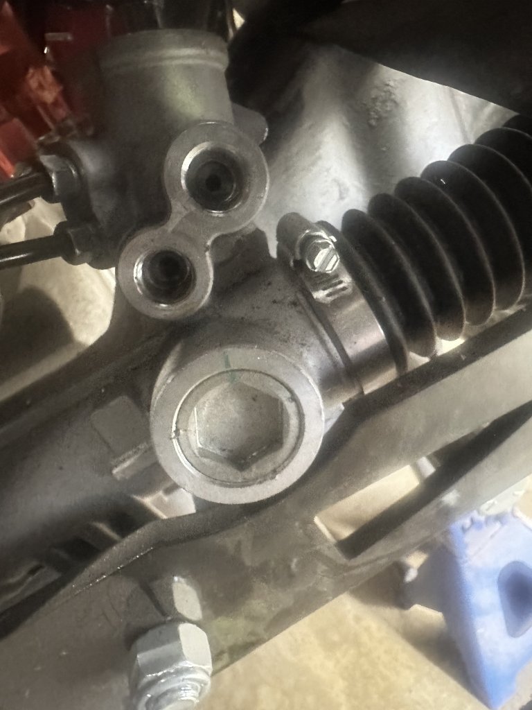

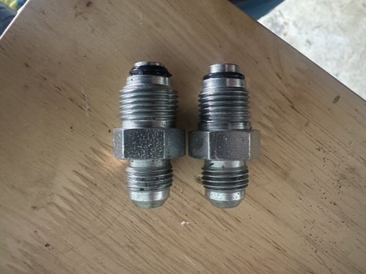

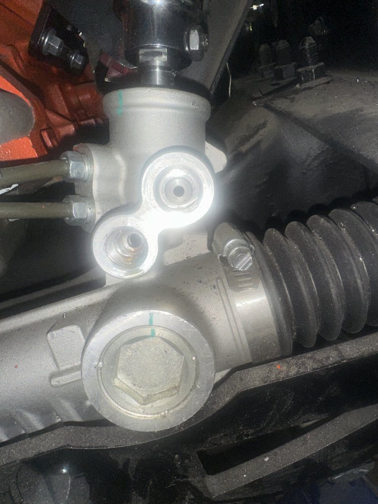

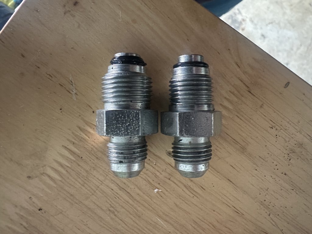

I got the same conversion kit but I’m having trouble identifying which port is the pressure side. Any help ?
