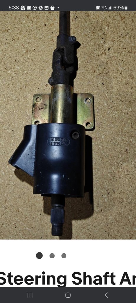

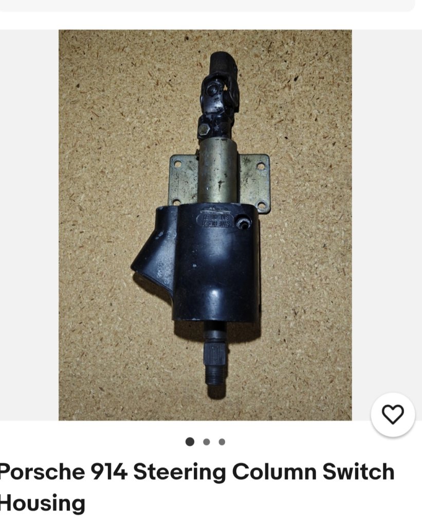

Just throwing this out there and it is entirely up to you to think it through,see if it's something you can make work etc. I've actually worked on cars where the steering column itself,was mounted to the dash entirely. The column ended inside the car and the steering shaft came through the firewall several inches to mate to the column. I don't think it would be that tough. But I also haven't done it. I don't have any pics,I'll see if I can find some.

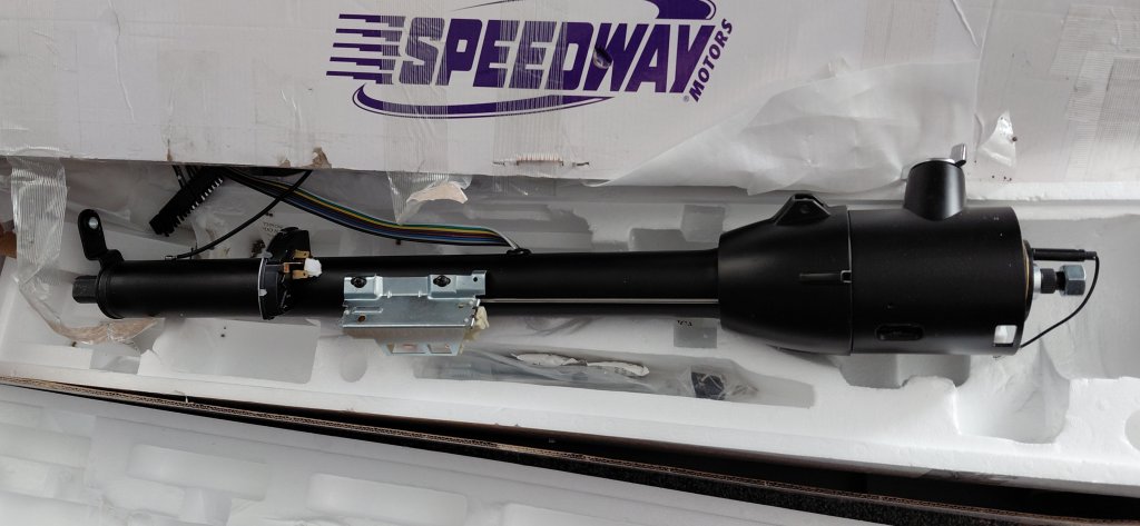

Well i hope getting this 30 inch column installed will be the ticket to giving me the room i need for the steering shaft. Its a gm universal column so install shouldnt be too bad. Ill know soon enough i suppose!

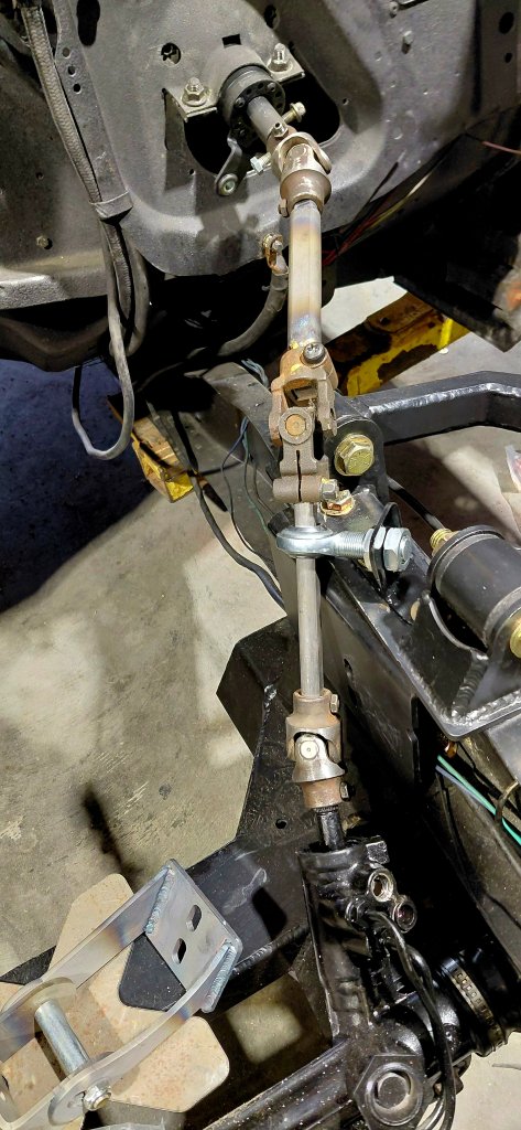

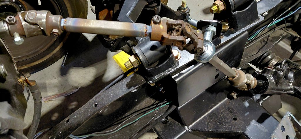

The plot thickens ... The new 30 inch steering column helped but didn't directly resolve the issue with the steering shaft. There are still some minor tweaks i can do that may get me there, i dont know...but what a nightmare. For someone to market something like this crossmember as a bolt in product is a great example of stretching the words "bolt-in". Not offering the parts or even mentioning what will be needed gives the steering the customer the illusion that everything else the truck normally would utilize can be used.
Sure the crossmember bolted to the frame, but you now have to buy all new steering components. Keep in mind, these new steering components, (that were never mentioned you will need in order for this product (crossmember) to even allow your truck to be drivable), will be operating at angles they are not recommended to be, those angles being their functional limits.
Id say that information would be worth mentioning to the customer. Am I wrong?

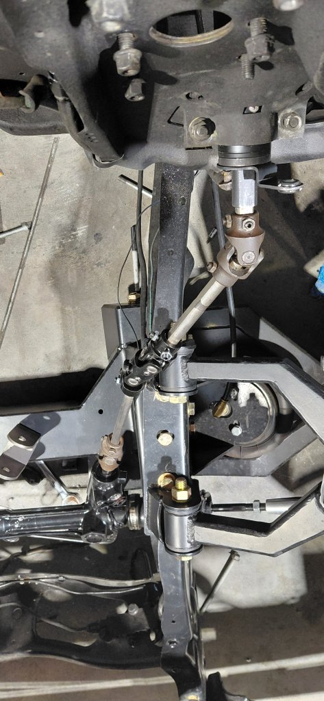

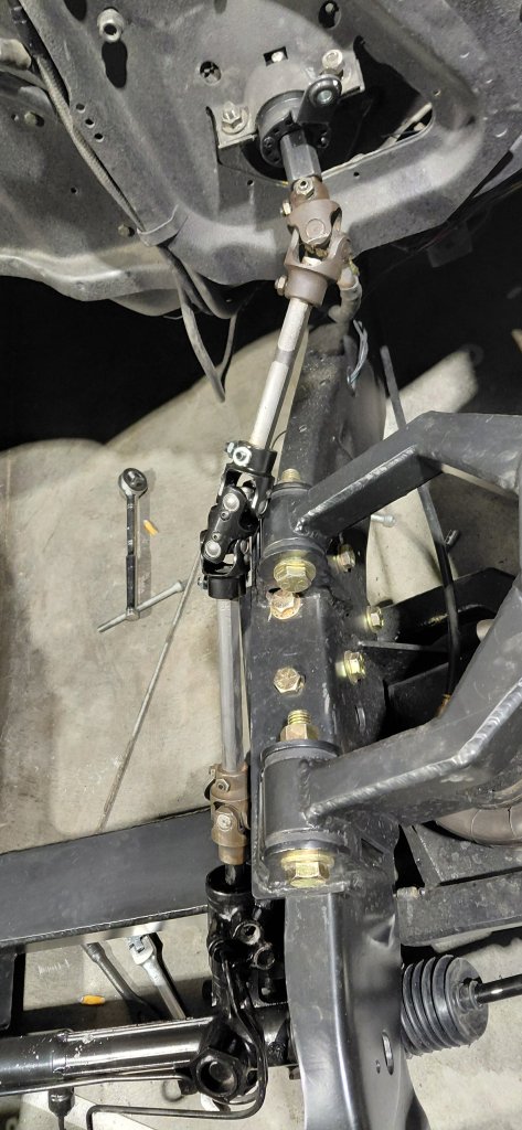

Ditched the dual u joint and used a sn95 mustang u joint. Didnt realize until it was done that the upper shaft joints are out of phase. Should i care? it turns fine, no binding.. im pry just going to roll with it and cross the bridge when the problem arises. But wait.... theres more! The steering runs straight through the center of where the drivers side engine mount is supposed to go! The cad file sure made it look as if there wouldn't be a issue. Time to redo the drivers side engine mount and frame stiffener as it's called. Just what i wanted to do....
