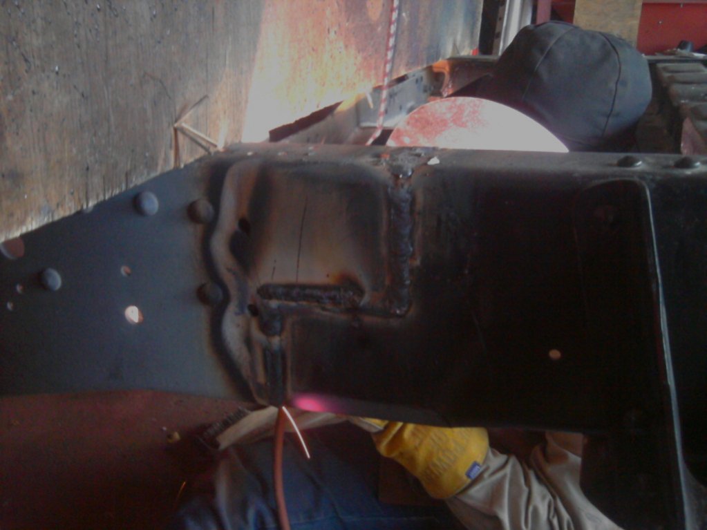

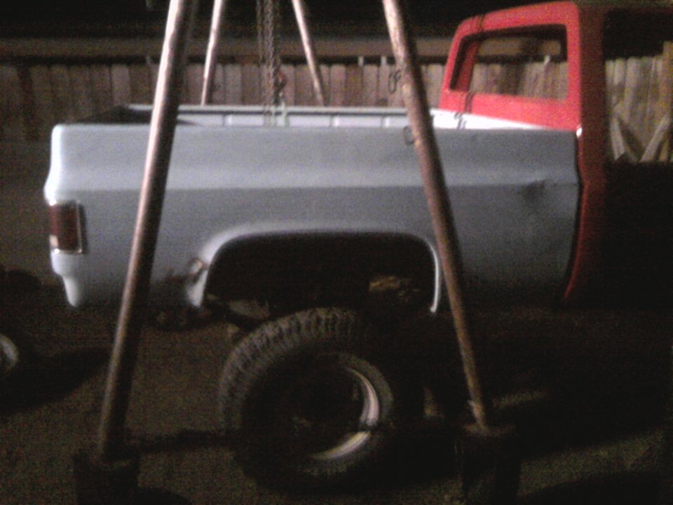

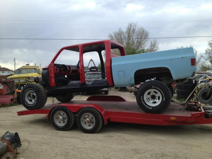

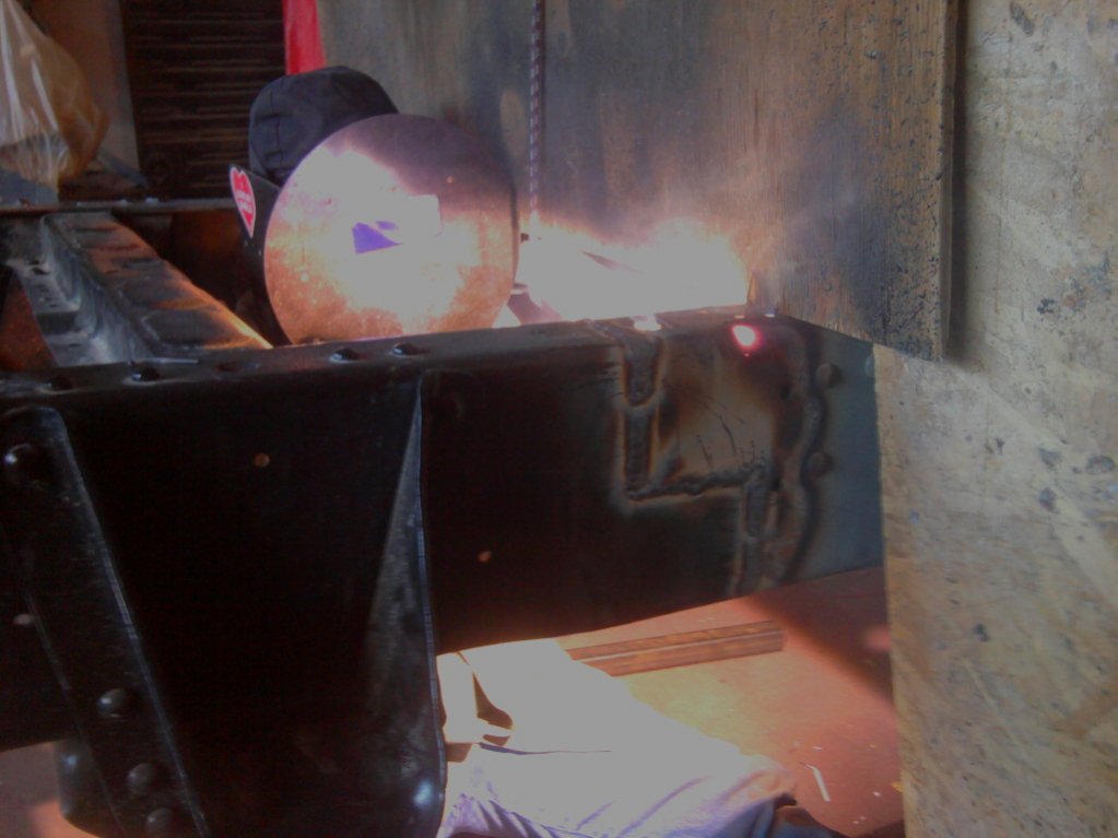

bad idea to cut and splice the two different frames. the crew cab as a thicker frame and a taller frame under the cab. bad idea in my opinion.
strip the frames down swap the 4x4 engine cross member and spring hangers onto the crew frame. if you have the ability to splice the frames then swapping those parts should be easy.
and you can cut the crew frame to a short bed. I did it to my crew cab some details in my build thread.

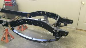

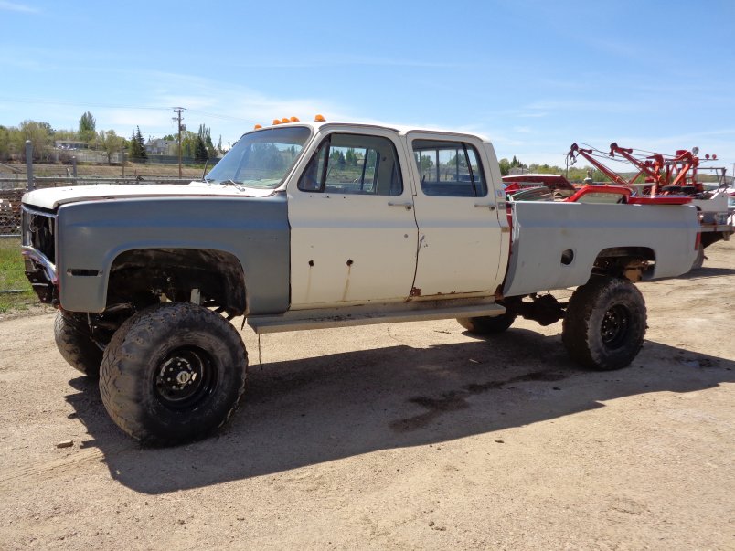

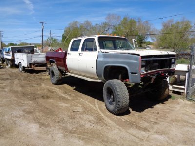

the c 20 crew cabs used he same frames as the c30 1 tons.
if you can find a 4x4 it will be the easiest way but if not converting the c20 to 4x4 is the next best thing to do. a lot better than cutting and splice the 2 different frames.
it a lot of work but it is not really that hard. its all a matter of either waiting to find a 4x4 or just build yours.
I am the type of guy that hates to wait if I can't find what I want I build it.
I do have a 4x4 crew for sale but I live in rock springs wyo
I would let it go for 2,000
or if interested I have a idea for this truck but I would not use the frame so I would sell just the frame

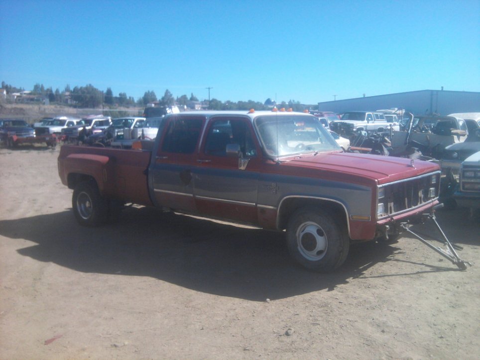

After finding out that the crew cab C20 uses the same frame as the C30, now I'm tempted just to make it a dually, slam it, find a crew cab 4 wheel drive to mess with instead, and give the K10 to my brother.

lowered dually looks sweet I have one of them as well
