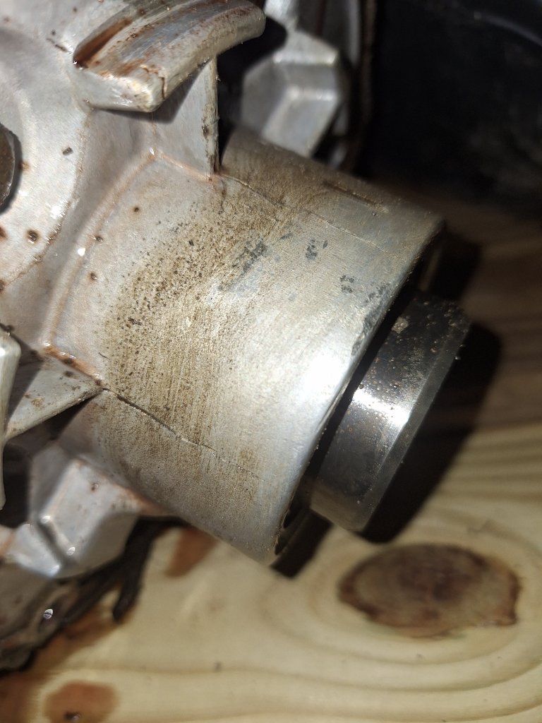

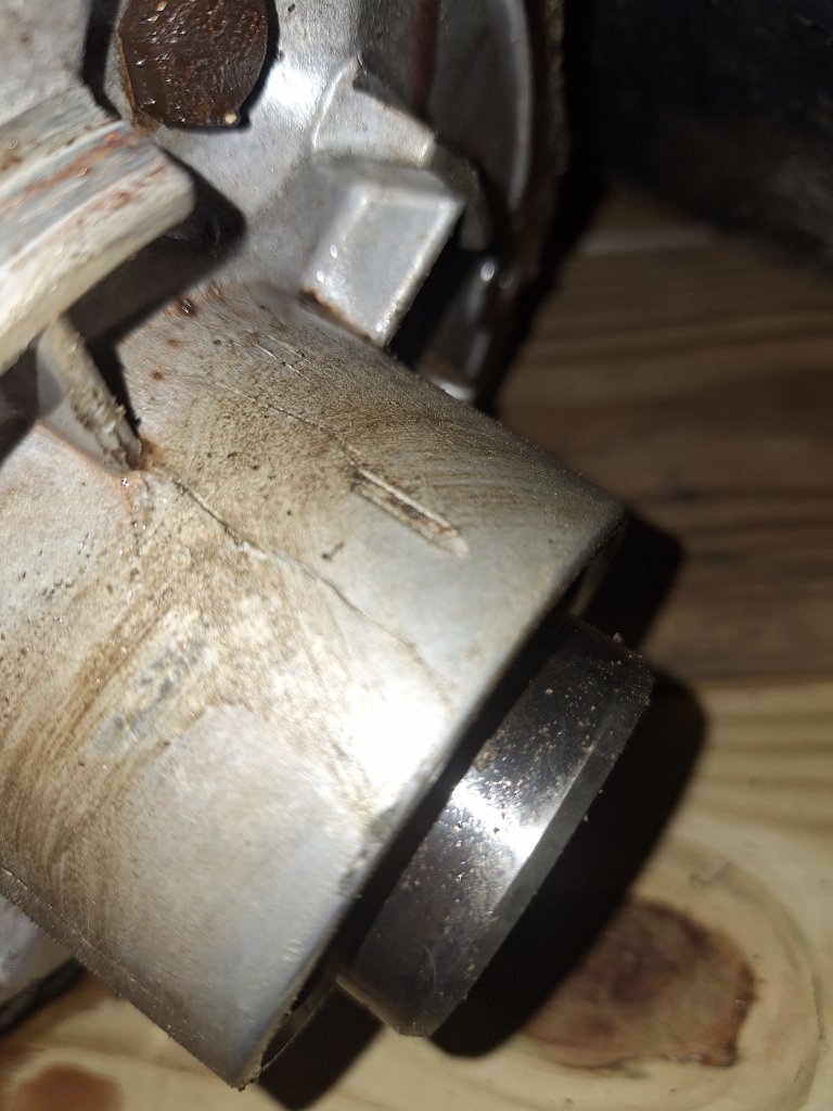

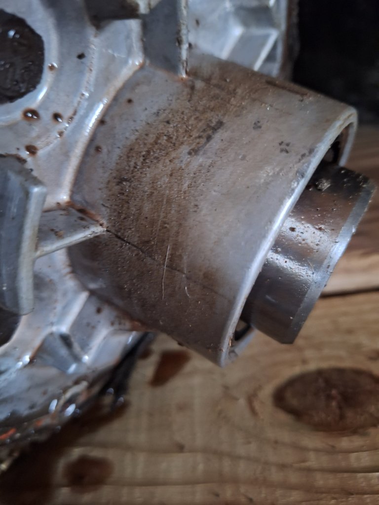

So I've cleaned this case up and there are cracks or what I think are cracks, don't know if they go all the way through. Anyways got another question I hear the input shaft is different on these depending on the trans in the truck, I kinda thought they were all the same. This one came off a 350 turbo, my project truck has a 400 turbo in it and I've been told there's a different number of splines on shaft is that the case? And if so I assume I can change the shaft out while rebuilding it. Never messed with transfer cases or transmissions before so I'm pretty green in this area
use a large sharpie after cleaning the surface, then wipe the same area with a cleaning wipe just across the surface one time, if its a crack it should penetrate a bit but then the wipe will or should eliminate most of above-surface stuff
