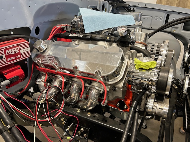

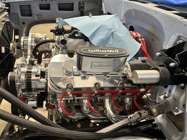

We knew this was going to be tight, but finding that a stock hood leaves no room for the large air cleaner we need for this build. We want to use an 8" tall element to let the 632 breathe, and when mocking up the stock hood, only have about 2" of room at the front of the air cleaner.
I am not a fan of the cowl hood look on a square, and even then can't find one that is a true cowl hood, they all are a false cowl with the standard hood frame underneath.
Does anyone make a true cowl, or is there an air cleaner option that allows for my limited space? I'm thinking like a modified cold air intake of sorts, but for a carb'd engine. Thanks

There's a reason GM used a snorkel and ducted cool air from the core support. 632 eh? Let's see some pix.

I'll get some pics. In the meantime, I found the USA1 functional cowl hood, but trying to verify the opening measurements. If anyone has this and can measure for me I'd appreciate it. Thanks!
