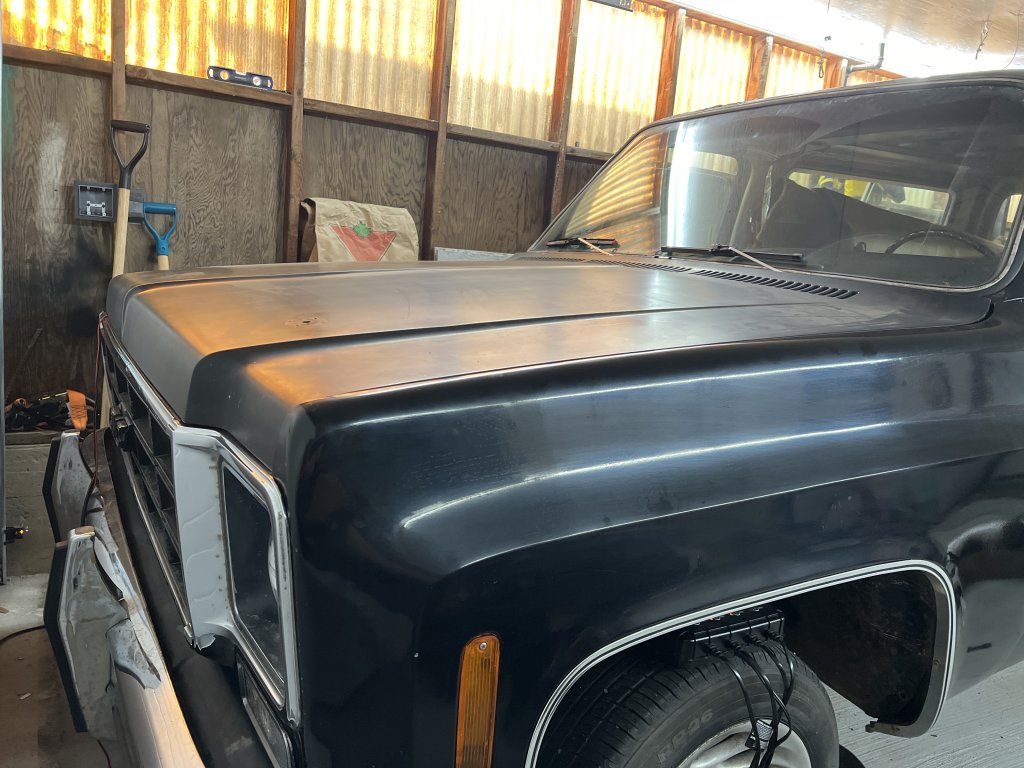

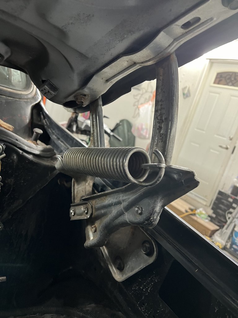

I know nothing about Chrome but maybe it's the Chrome springs having an effect? If it's even possible. Pics ??

I can't see the Chrome. Maybe they just painted old ones with chrome or aluminum paint.

I live in northern Canada. They are chrome but the pit and go dull very quickly with our weather

I wish I had more advice on this but It's possible you're hinges are tweaked or just poor quality like mentioned before. How bad Is it when closed? Everyone on here wants pictures lol.

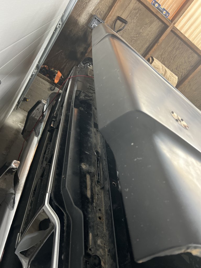

The newer hoods have a flat nose, the "rib" in the center of the good dies into it instead of wrapping all the way to the edge.
Best picture I have is upside down LOL but here is the flat nose hood

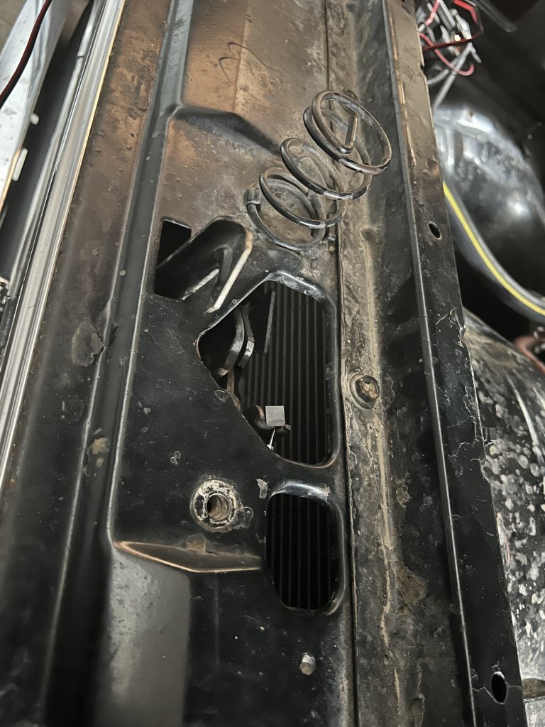

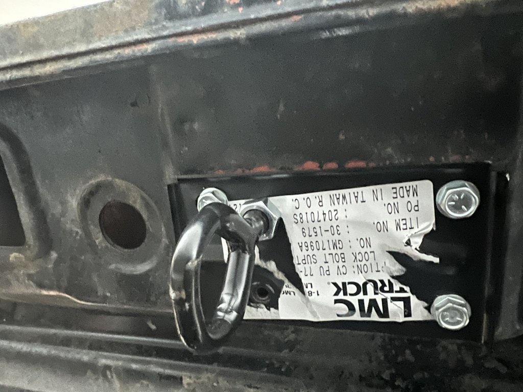

You could be on to something here. I was finishing up the hood latch and realized there is no catch latch hole on the hood.

I'd say you have an early 70s hood with a late 70s remote release hood latch. The safety hook was oriented differently on the early "outside" release latch. Should be able to pop a slot in the hood and get it to work. There a good witness mark on the hood. Good news is it looks like you figured it out.

Yes, the remote hood release setup has that hook looking thing on the hood The front end hood thing should be like a pointy pin if memory serves

I’m happy to say I have it sitting down properly now and I even have the hood catch working.
Thanks to everyone for the help on this one.
