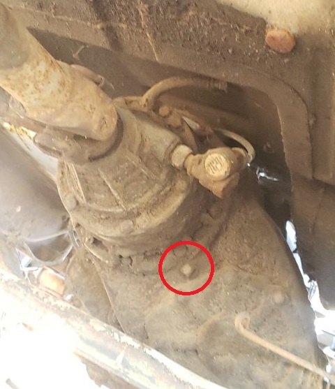

this is a 1978 truck :) lol wonder which one it was, if its the deeper chain that honestly may be enough for me to choose that going forward as tcase for the truck.
Do you know what that pipe is about? the front axle has warn hubs from the era, the same kidn that manual hub 208 trucks got in the 80s(at on d44 axles/10 bolts) which is also purchaseable today but they are clearly that old themselves, so I think the truck stands good reason to believe had the part time done if it was still functional when it came into our family in 2000 ish and has sat since. The pipe is what makes me think its going to lubricate the thing back there but im unsure how it sends fluid with the factory insides, maybe they had pumps or something with part time conversion?

@AuroraGirl all I see is a plug, no indication of a conversion.

@AuroraGirl is that attached to the transfer case? I thought that was the pivot rod for the eBrakes

you can see on @Dooley photo, the pipe pretty clearly, you're looking from above the case. on yours all i see is a standard plug. the goal was to raise the oil level in a manner that the tail housing would hold oil, that's where the oil pump is

I have a converted 203 in my 75 K25 - truck is fairly new to me, never been inside the transfer case. It has a piece of threaded pipe so you can overfill it for the part time conversion. The truck had been sitting for a while when I got it so I changed all the fluids, including the transfer case, with straight 30w. First couple of thousand miles all worked just fine. In the last couple of months it’s developed a nasty metallic buzz/grinding sound in 2wd high. I already checked the shifter adjustment to make sure it’s grabbing the correct gear and not drifting into neutral or something, and checked the fluid level. The sound comes and goes, I can go a whole day without hearing anything, and the next it sounds like a can of marbles every time I use anything but the lightest touch on the throttle. The sound when it’s particularly bad causes the shifter to visibly vibrate forward and backward at a high rate. If I shift into 4 lock it’s perfectly fine, no sound, either with or without the front hubs engaged. Does this sound like a problem with the part time kit and/or differential assembly in the tail housing? It’s my daily and I’m trying to get an idea of what I need or probably will need before I tear into it. I’m looking at a couple of two piece cast differential housings to possibly order in hopes that the problem lies with that crown gear engagement rings. Thanks in advance for anyone’s thoughts.
