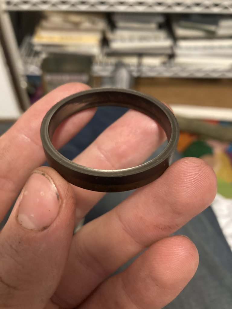

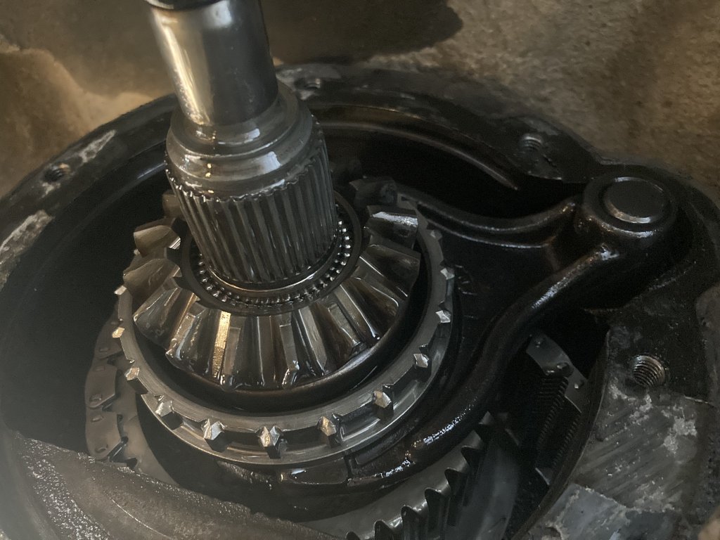

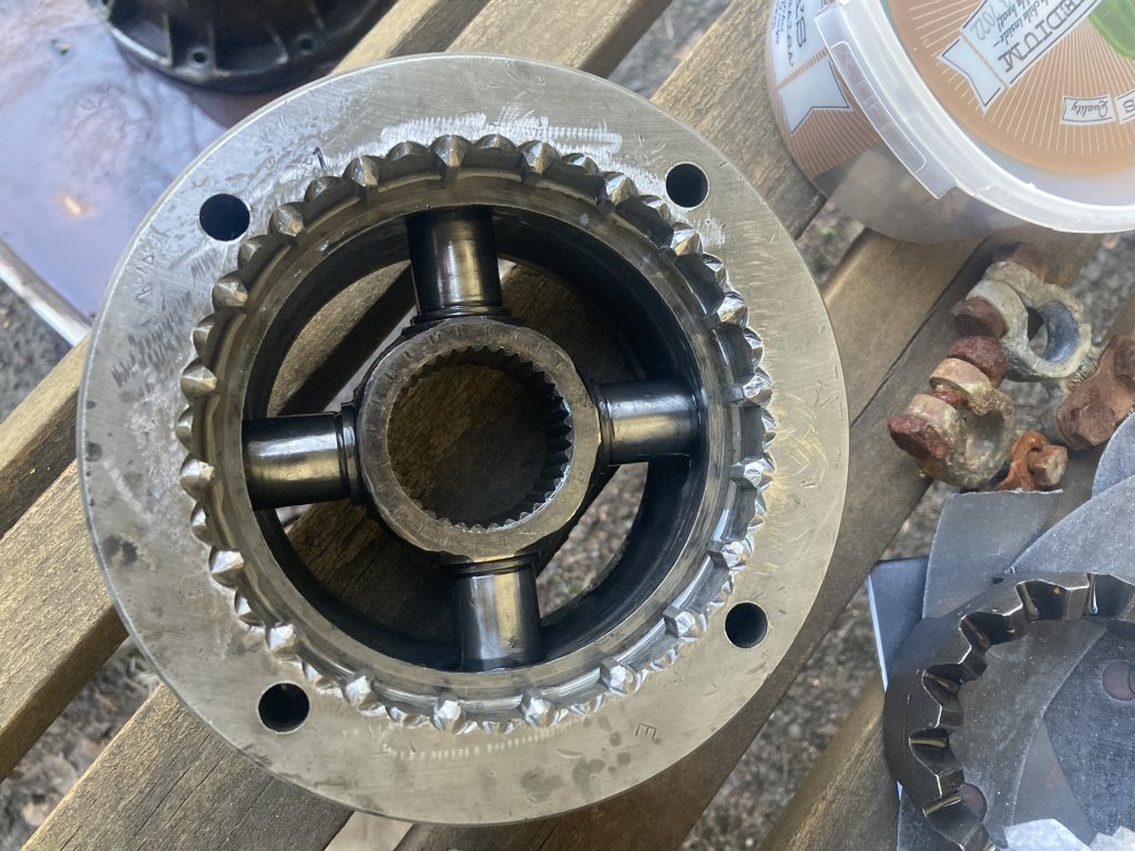

Well, belated update but I finally tore into it - my problem is of a similar nature, but caused by a different part. It looks like I have exactly the same part time kit in mine. My Torrington bearing looked just fine, but the spacer behind it has been eaten quite substantial by the roller needle bearings behind it. I think this may have been caused by poor shimming when this kit was installed, there was no play at the output shaft. Same result though, the 4wd lock selector has clearly been drifting into the differential housing, the teeth and face are noticeably chewed on mine as well. I can’t find this spacer anywhere - does anyone either have one or at least have the dimensions for how wide it should have been originally?

I missed that in there, thank you. it’s specked out to .31 inches and I just measured mine at .28. Not a huge difference but maybe just enough. There’s a clear groove worn in the back side of the spacer and it’s definitely making contact.

Yep, that part all looked fine. I’m amazed it ate the spacer behind the Torrington before it ate the Torrington itself.

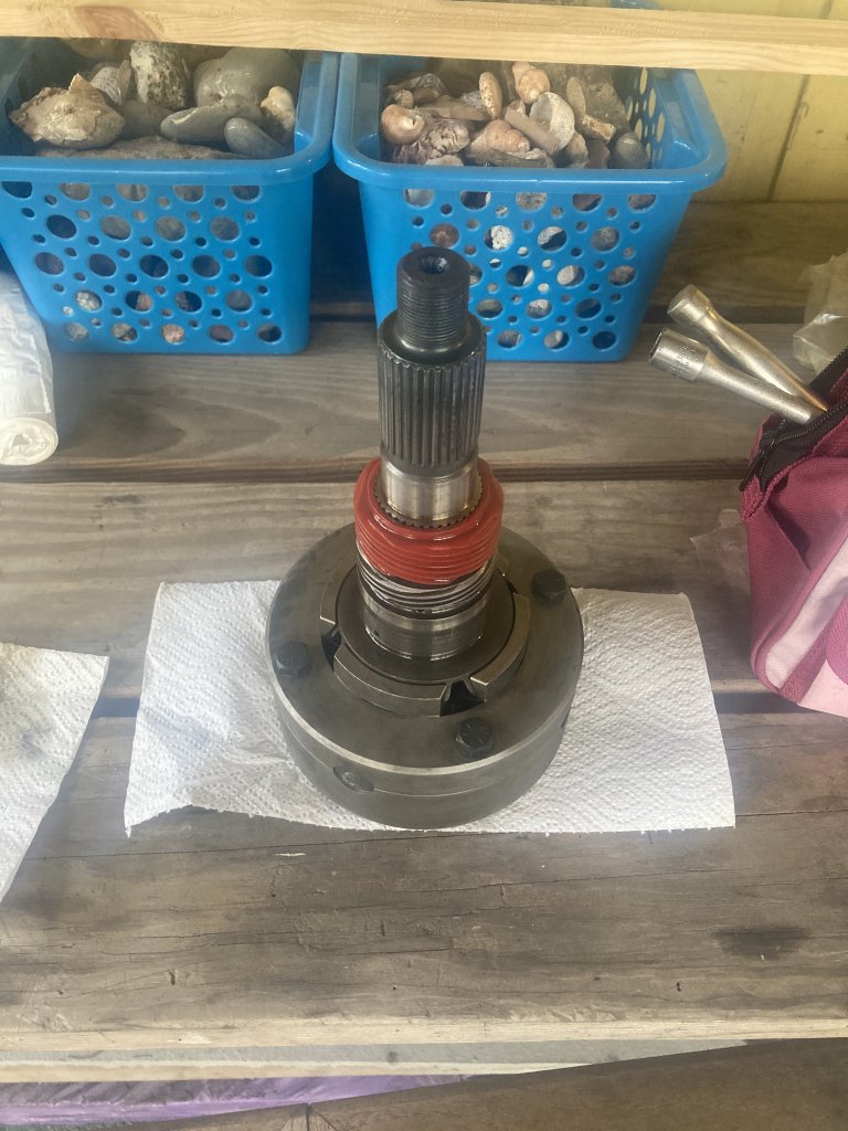

Final update for me - I installed the mile marker 501 kit, and replaced the differential carrier with one with non-chewed up teeth, and found a replacement spacer at a local trans shop. All back together and filled with 10w30, no more noise, shifts well, and as a bonus the driveline clunk I used to have is 90% gone. As a side note, I talked to the guy at the shop for a while about the old crown gear style part time kit, and he said that because they don’t lock around the output shaft, they constantly build and disperse thrust and destroy that Torrington bearing and/or spacer. His recommendation was to get it out of there and replace it with the 501 kit or the full shaft kit if that could be found.

I tried to use the 501 kit wedges but couldnt get the tail housing fully seated. I assumed it was part of the old conversion kit i was using or i did something wrong... either way i was about 1/4 inch from fully seating. I know where the original parts are but cant put my hands on them at the moment. I need to look at them and see if the kit replaced the spider gear or carrier
