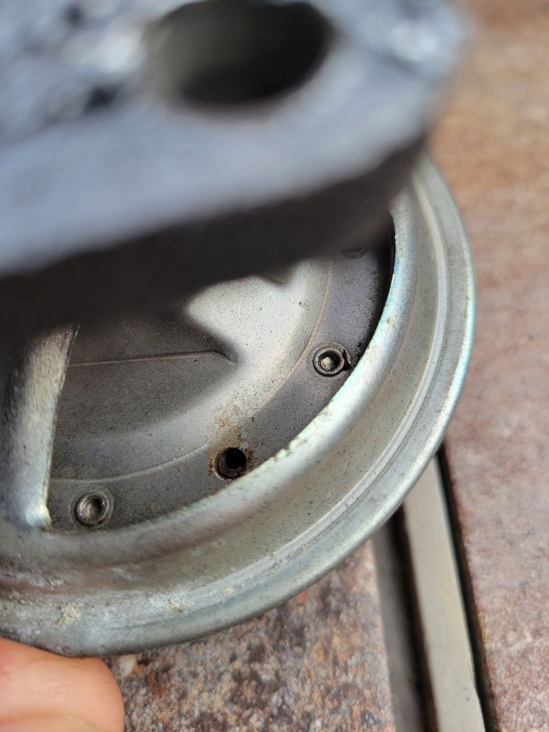

here is the proper EGR part number AC Delco 214-5073.
if you have no more off idle stumble with the EGR hose plugged, I'd suspect the likely culprit to be the wrong type of EGR if the EGR solenoid is operating properly. the valve and the solenoid components are tested separately.

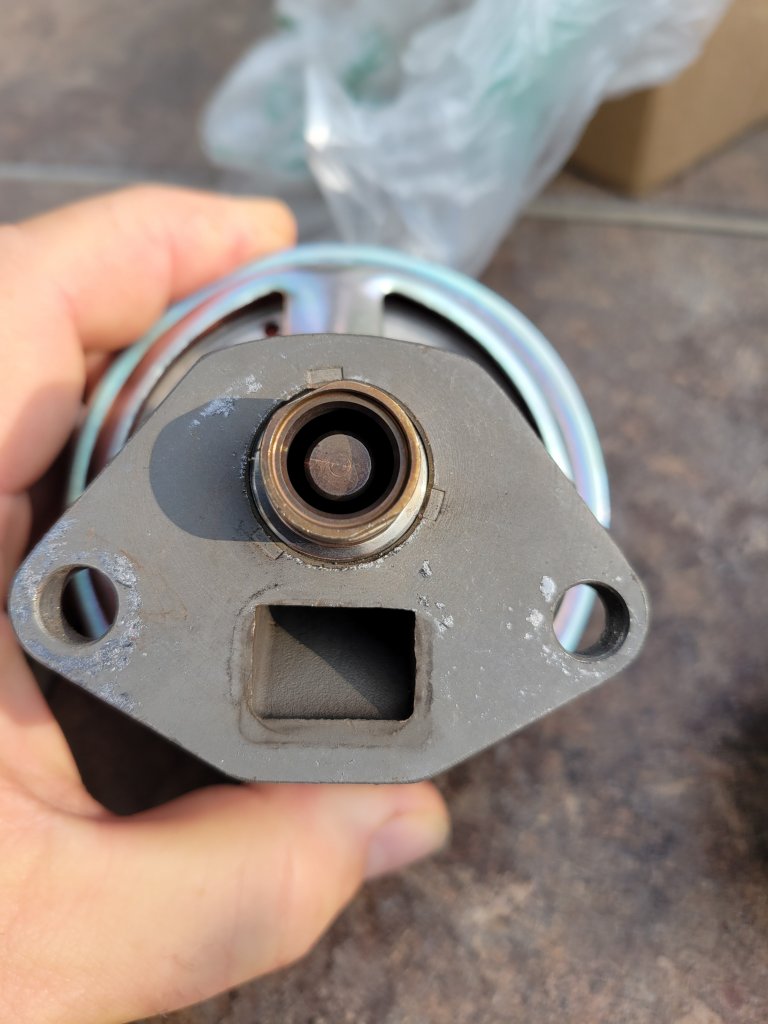

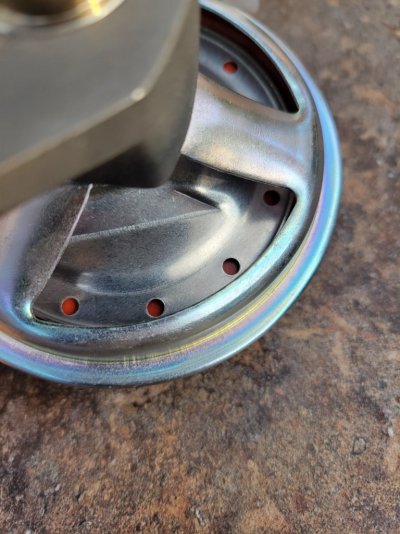

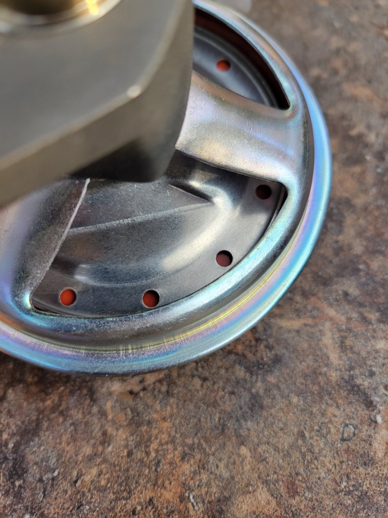

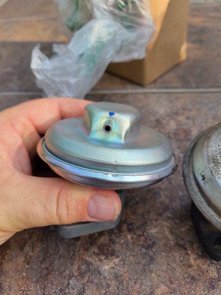

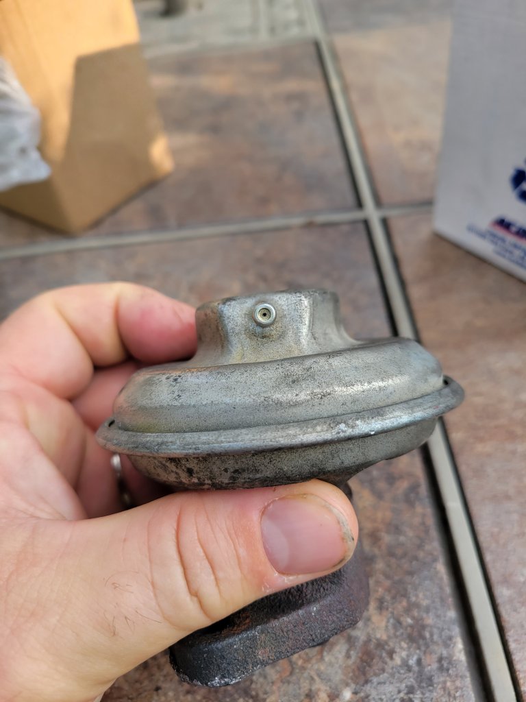

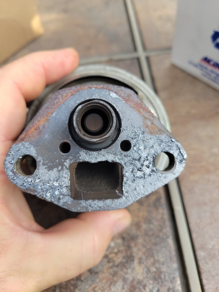

here are photos comparing the old one (correct part, but old) and the new one (incorrect part) from when I had issues. the correct new one I acquired later looked exactly like the old one, just clean
gmbellew
May 27, 2018
1,582
1,823
Kansas city
glen
suburban 1500
last pic because you can only attach 5. I'd pop yours off and compare to these pics to make sure it looks exactly like the old one in these photos

@gmbellew the number on the EGR in my burb says 17087194 and I got excited. So looking at my local parts store options they have an AC Delco with the part number you gave me but the number on my burb is listed as the same.
I'm still gonna pull it out to compare and look though when I won't be dodging raindrops
