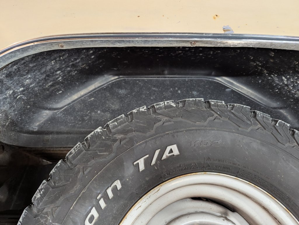

I have had good success with rustoleum flat or semi gloss black, the tall silver professional cans. I did the wheel tubs on my 76 eight years ago, DA'd down to bare, quick wipe and sprayed, no primer. This is what they look like after daily driving the truck from 2018 to 2023, hardly washed, driven in all seasons, etc.
