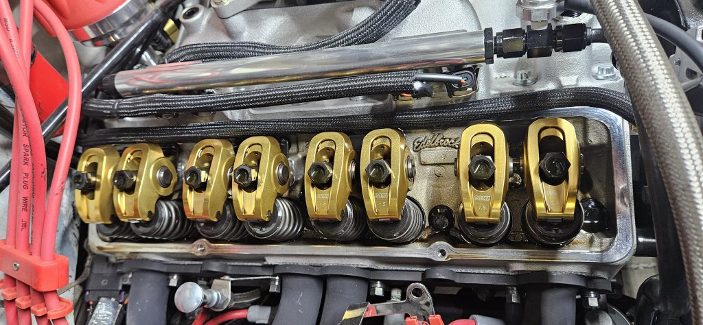

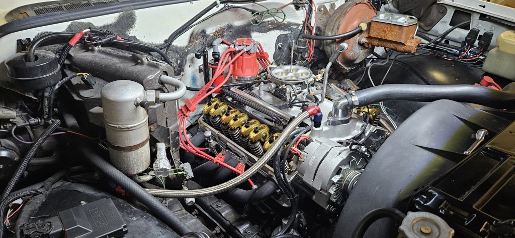

Well, I just saw this and am late to the party but here goes. I bought my 78 several years ago and it had the stock original born-with 350 in it that was very tired. I went looking for a machine shop that could do the machine work only in a reasonable time and gave up. In my neighborhood the wait time was 6-12 months, and that is just machine work, no assembly. I went looking at options and quickly gave up on the LS as I think they are an ugly engine externally and frankly this is just a toy so new tech didn't really matter to me. I found that I could buy a brand new block, rotating assembly and aluminum heads for less than the machine work and same internal parts. I splurged on EFI ProFlow 4 and Edelbrock heads and SCAT 383 with cast crank and hyper pistons. All in $6K. Could've saved $3K if I'd forgone the EFI. That is all new parts and the OEM 350 is complete sitting on a stand in the back of the garage. The Dart block is a priority main oil feed with a one piece rear main. Roller rockers and Lunati camshaft and it runs great. It took about a year of budget and build but I'm extremely happy with the outcome. I'm building my Pontiac 455 right now and frankly the SBC parts are SO much cheaper and plentiful. Would do it again in a heartbeat and highly recomended.
Thanks for speaking up! The machine shop here is pretty quick, and any extra time they take will just give me more time to come up with funds. But time will tell, who knows, they could get the block there and find something wrong with it like a crack. If that happens, I will likely be buying an aftermarket block. And yes, it’s pretty impressive how cheap parts are these days. Even for a stroker kit.
