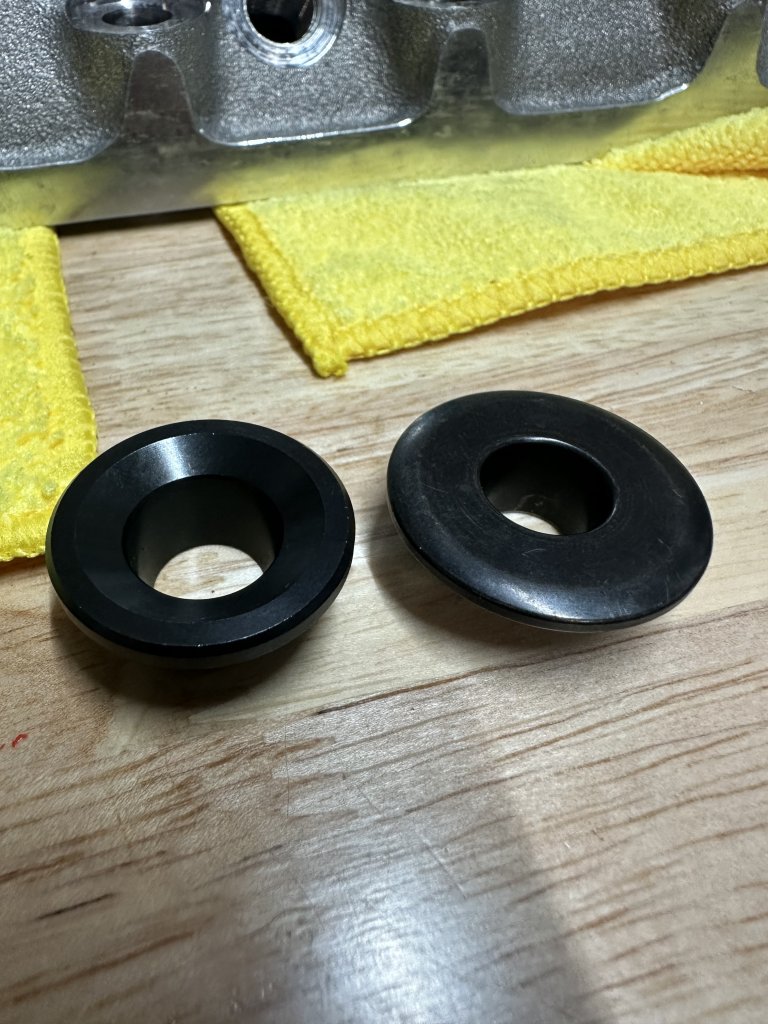

Got the valve spring blues. You might notice that one thing here is not like the other. Howards retainer vs the existing comp cams retainer on the right.
What a pain in the ass. Valve springs got delayed, but did show up today….with all of the locks free floating around in the box. Miraculously, none were lost. No matter. Packaging from Summit must’ve been done by someone just clocking out.
I realize that there’s a ton of different setups but these retainers will make it impossible to get the correct installed height. It’s .220 off what it should be, at least. So that means I have to make another call to Howards tomorrow and figure out what retainers I need. This kind of ridiculous sometimes, all this fiddly stuff that wastes time.

Well, Howards was no help. The prior/original retainers fit fine and are very helpful in bringing the spring down to where it’s supposed to be. They gave me their blessing to use them since they have no other answer and they are within spec since the spring ID is the same.
I just got off the phone with Summit and ordered some .050- locks to get it where it should be. But time will tell, try and try again.

Spent a good part of the morning on the phone with Howards and then, Summit. Howards gave me their blessing to use the existing retainers, so that’s likely what I’ll do. I took the head with same springs installed with the the different locks and retainers to the machine shop, he said there’s wild industry variances and no standards for this stuff so it’s no surprise. This was totally unworkable. The one on the left is the Howards retainer, the original Comp on the right.

Woah, that's a huge difference. Enough that that's gonna effect closed spring pressure. Definitely prefer the look of the Howards, but that may just be because that's the heights of what I'm used to dealing with (LS stuff sits just like that).
Yeah, the Howards is the actual problem- it’s too tall so I won’t have enough spring pressure. I have some more stuff arriving today so we’ll see if after talking to them I’m on the right path.

Both my Flotek flat tappet heads and my Edelbrock roller race heads look like this and there is 2k in price difference between the two pairs. Typical for SBC I can't recall seeing any that didn't stick up that high. Looks like the Howards is trying to compensate for spring pressure buy raising the top of the spring vs cutting the seats deeper. Might cause an issue with some rockers contacting the retainer depending on their design.

That may be the case, and I understand what you’re saying. I can’t remember if I mentioned, but Howards wants the installed height at 1.75-1.76”. On the left, that’s above 1.95”, yet Howards says they’ve never heard of that. But the difference in the retainer styles tells the story, and the one on the right (Comp Cams on the same spring) is much more in range. Pretty close, but I ordered some -.050 locks to bring it back and I may have to play with it a little.
In the end, Howards gave me the go ahead to use the other style retainer. Let’s see how close I can get- it’ll be a game of locks and shims going forward.
