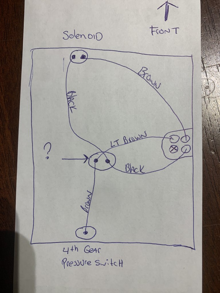

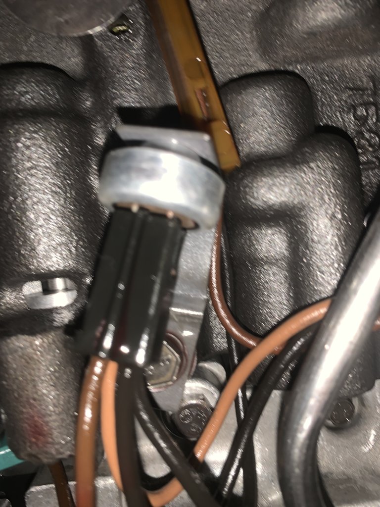

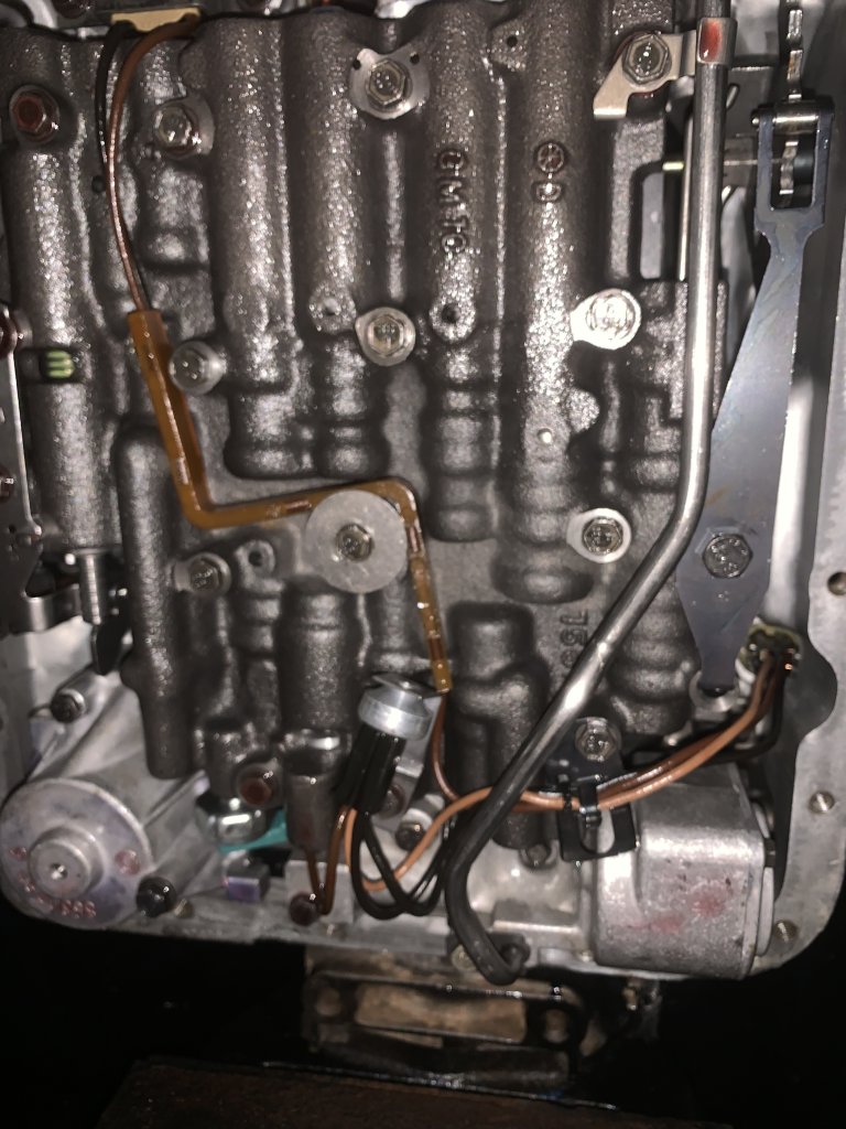

Took the pan and filter off to check out the wiring situation. It’s a little different from others I’ve seen pics of. What is the thing in the middle of the wiring harness that all of the wires go through? It has 2 connections, with 2 wires going to each spade. I’ve seen it referred to as an overheat switch?? Is this correct? Any harm in leaving it hooked up, or should I ditch it?

That’s a thermal switch. It’s designed to automatically lock the converter if the trans overheats. Not all 700 use one.
Alright
I guess I’ll delete that when I wire up my lockup circuit.
