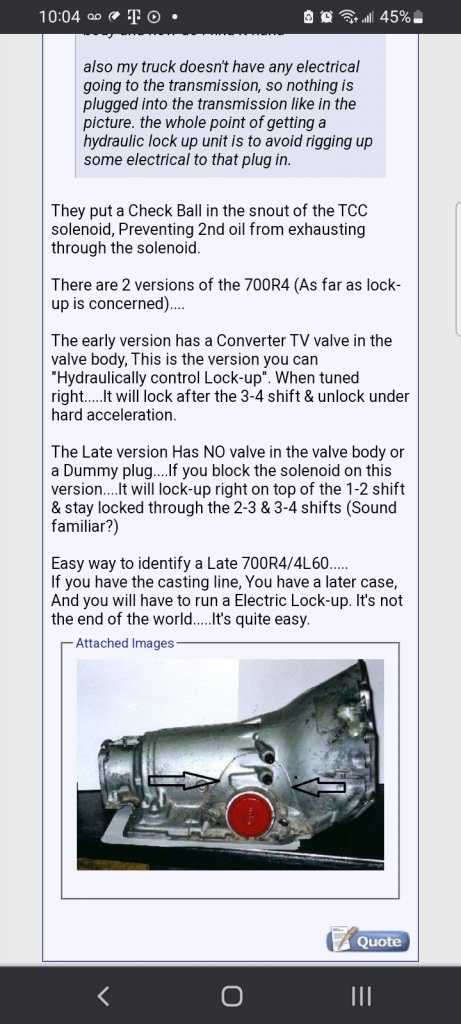

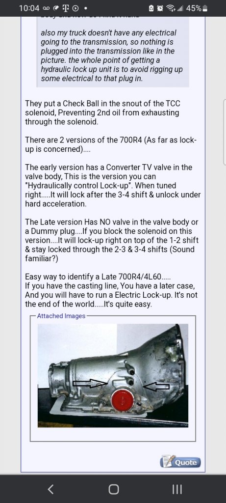

@Matt69olds not challenging,inquiring I did the checkball on my truck and was happy with it. Do you know about this screenshot Im putting at the bottom? What year was the change? And I totally agree a little wiring and a 4th gear pressure switch would be cheap and easy. At the bottom of post 5 I saidvI think all he needs is a pigtail and some help with the wiring. But my curiosity is really up now with the check ball what years does it work?

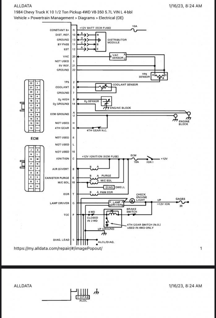

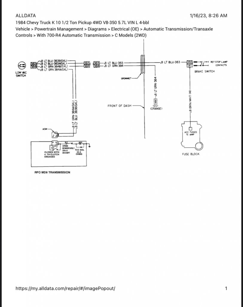

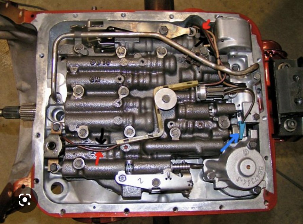

Every valve body should have a pressure port for a 4th gear switch. Some have one for 3rd.
The switch has a blue arrow pointing it out. You won’t be able to fit a socket on it with the 1-2 accumulator housing in place, you will have to use a pair of slip joint pliers to remove/reinstall.

Ah! I forgot about the early 700 with non electric converter clutch.
I friend of mine bought a REALLY nice tubbed 55 Chevy with a stout 400 small block. The engine had a dyno sheet showing 480hp, with the rowdy cam one would expect. The 700 in it had the check ball in the converter solenoid. With the radical cam, the car was uncomfortable to drive around town. It would lock the clutch as soon as it shifted into 2nd. The car would buck, jerk, stumble, the engine would ping, and didn’t drive the way a nearly 500hp car should.
I suppose if you had a light car, with a decent amount of low end torque, it might not be a bad solution. Not in that 55.

I guess this trans already has a pressure switch inside from the factory. It just wasn’t working obviously as no wiring was connected to the outlet on the drivers side. That’s what I need to address once I get it rebuilt and reinstalled.
I’ve got the 4 pin harness ordered. Just need to figure out how to wire it up, and when to turn it on/off.

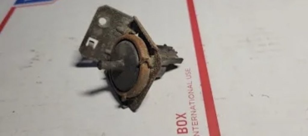

In my experience that mystery plug looks like it could belong to an oil pressure switch for a gauge or dummy light, I have seen them with both styles depending on the vehicles options. And as a technician our job is to repair a vehicle to “like new” conditions or better, so in my opinion I would recommend that you connect the required components to have a functional torque converter lock up. My 85 K10 Blazer has one of these valves on the firewall for the lockup. And here are some resources to help you if you decide to conquer the task.

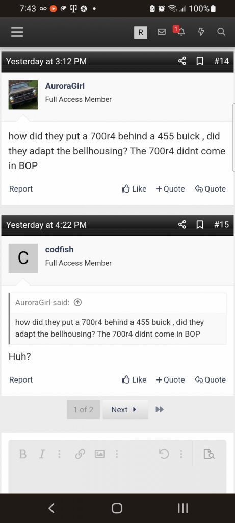

how did they put a 700r4 behind a 455 buick , did they adapt the bellhousing? The 700r4 didnt come in BOP
BOP = Buick, Oldsmobile, Pontiac
GM's lineup went from least $ to most $ Chevrolet, Buick, Oldsmobile, Pontiac, Cadillac. At some point they began using a lot of common parts in the BOP models with Chevy and Cadillac on their own.
By the 1980's GM had stopped making the different BOP and Cadillac engines so everything used Chevy engines.
