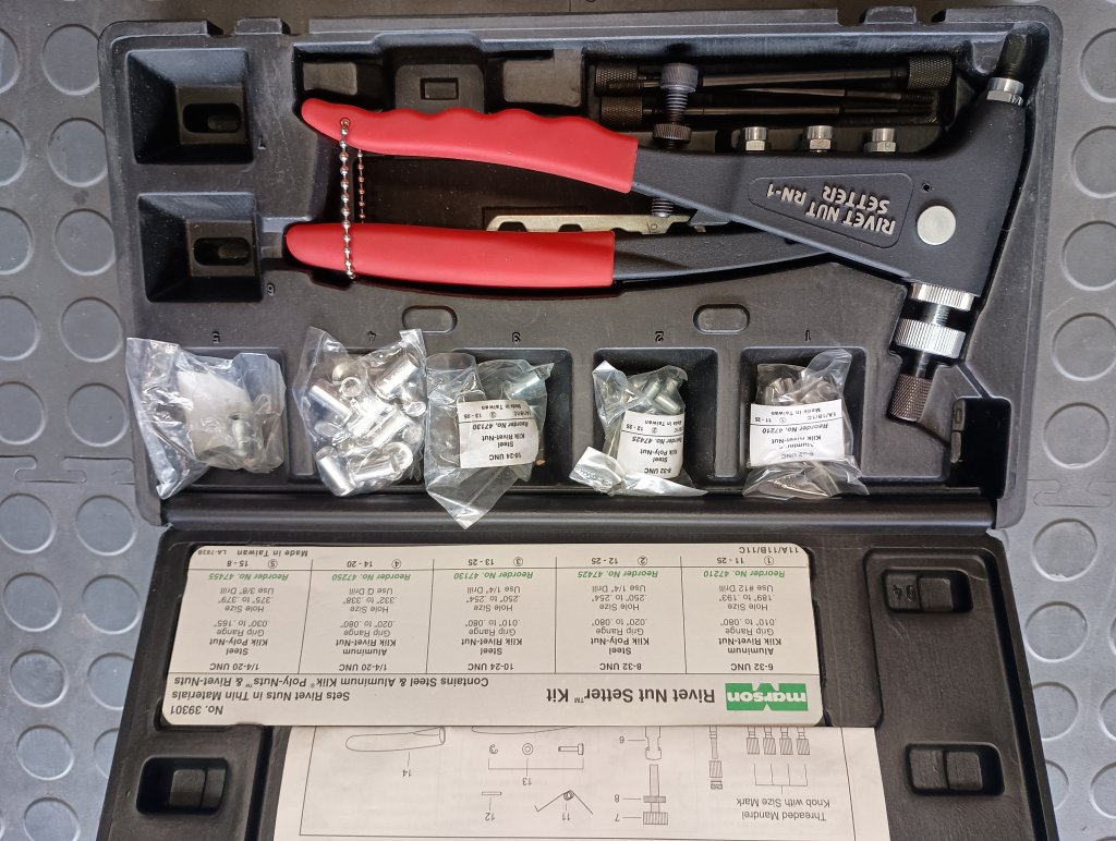

I splurged and bought a nutsert kit. Has the tool, various aluminum and steel nutserts. I put that S**T on everything! Best thing I ever bought. Except for maybe the weather pack connector kit.
Which one did you get and how does it differ from a pop riveter?

@Doppleganger
It has different size "rods" depending on the size of nutsert you're using
