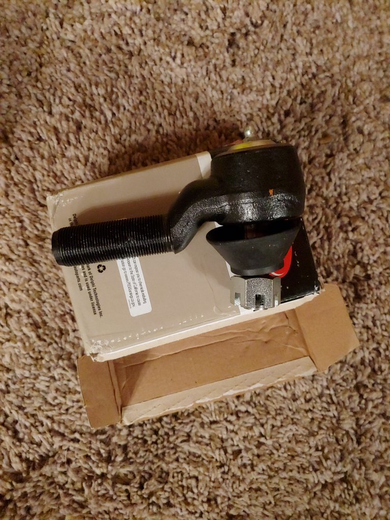

@AuroraGirl.
Yeah....ive got the older style where the steering damper connects to the middle of the rod. Both rods are also off set. Like such....
