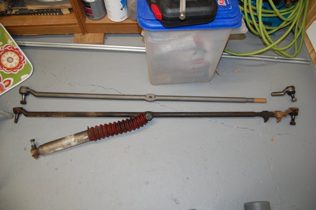

I looked up the parts for the short end of the tie rod and I’m still not sure of the right number. Maybe I can find my receipt from where I purchased the new one, but it will take some searching.
My ‘75 K25 has a Dana 44 HD axle in 4.10 ratio. I’m not sure what is different on the HD axle, but it was used on the 3/4 ton trucks. I’m going to attach a picture of my tie rod, just for reference.

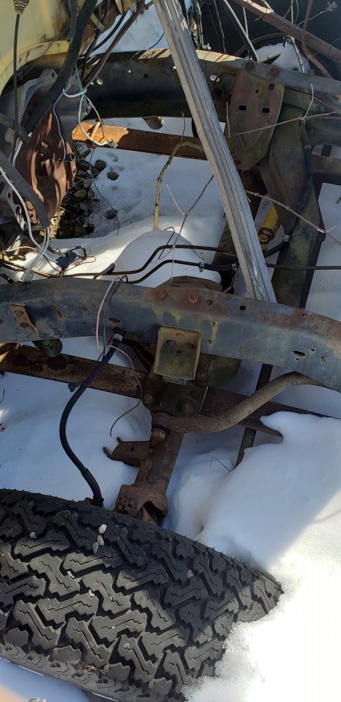

its possible i was mistaken but the shaft on the right is different but it was, for what i thought, a dana 44 on a GM 70s truck but it may have been the light duty while the left broken ones are from my 80 k25
the shaft I took out of this one on my k25
this next is the axle I took it from 77 k25
