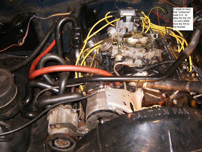

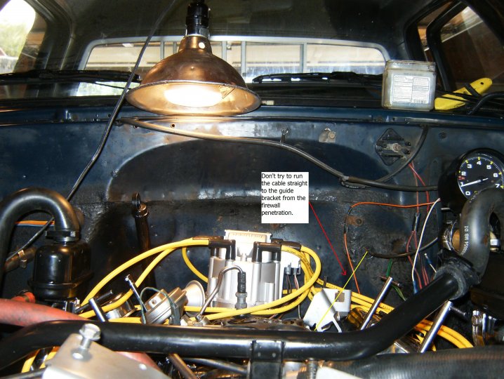

Just be sure you are not trying to run a straight shot from the firewall to the cable anchor bracket and then to the throttle. It needs to be in a spiral shape ( like a pigs tail or a cork screw) to enable it to shift over the foot or so from the firewall to the bracket.
If it is forced to go in a straight line it will bind and fail quickly.

Ahh makes sense about the springs. The pedal is pretty firm, but I wouldn't call it excessive. The spring is pretty funky looking. I would think an old spring would create less tension?
Thanks for the pics. I do have it spiraled from the firewall to the bracket
