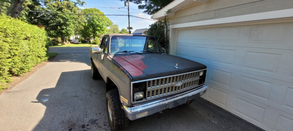

Hi, I just bought a 1981 chev very recently and I avoid driving it because of a slight issue. When I put it in reverse, 2nd or 1st gear, the brake light on the dash lights up for a second.
I'd rather be safe than sorry, does anyone know what the issue could be?
