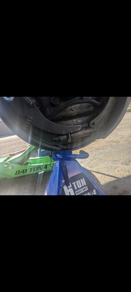

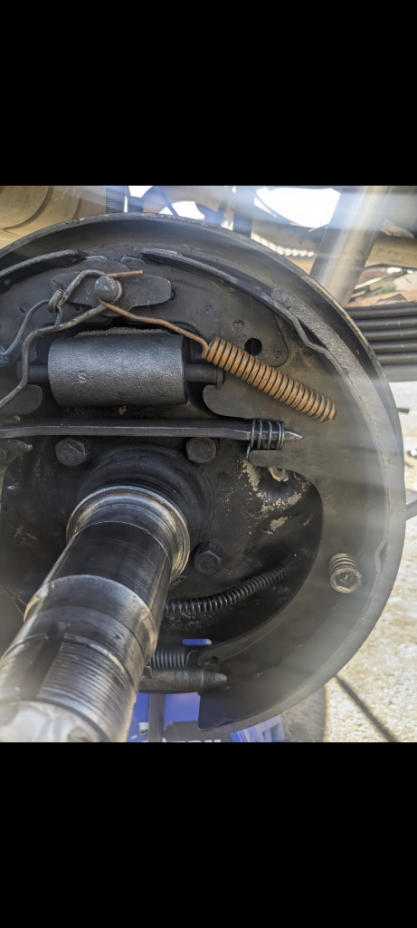

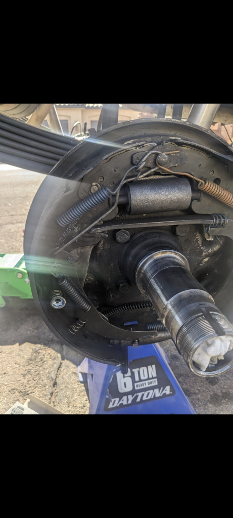

Can you provide a picture of rear brakes?

I'm out of town for work for the next week but I'll attach whatever photos I have. These are of the passenger side, which is the one the adjuster was slipping.
Again, thanks for your help.
