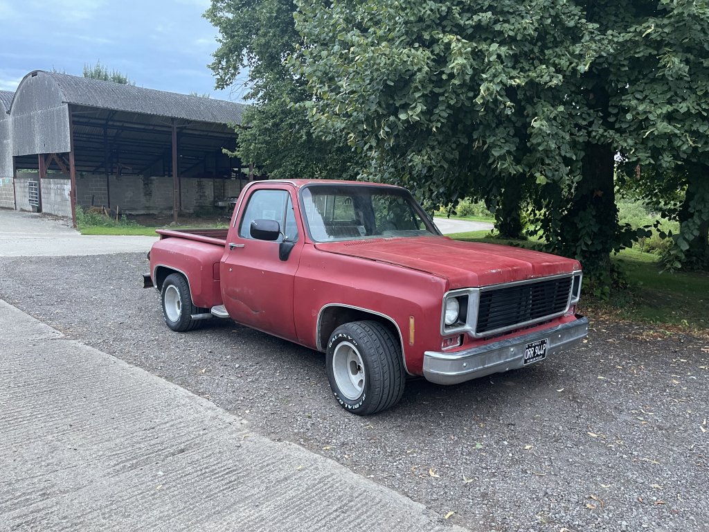

put a new master cylinder in and it’s braking so well now! thank you for your advice
