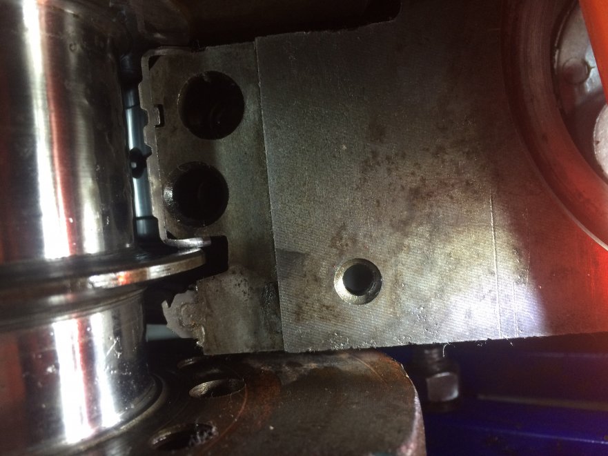

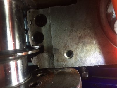

Just removed bearing cleaned all bearings and surfaces with brake parts cleaner just put crank back in here are the pics looks like the front fits the best buy still doesn't thrust bearing area defiantly does not fit ..
