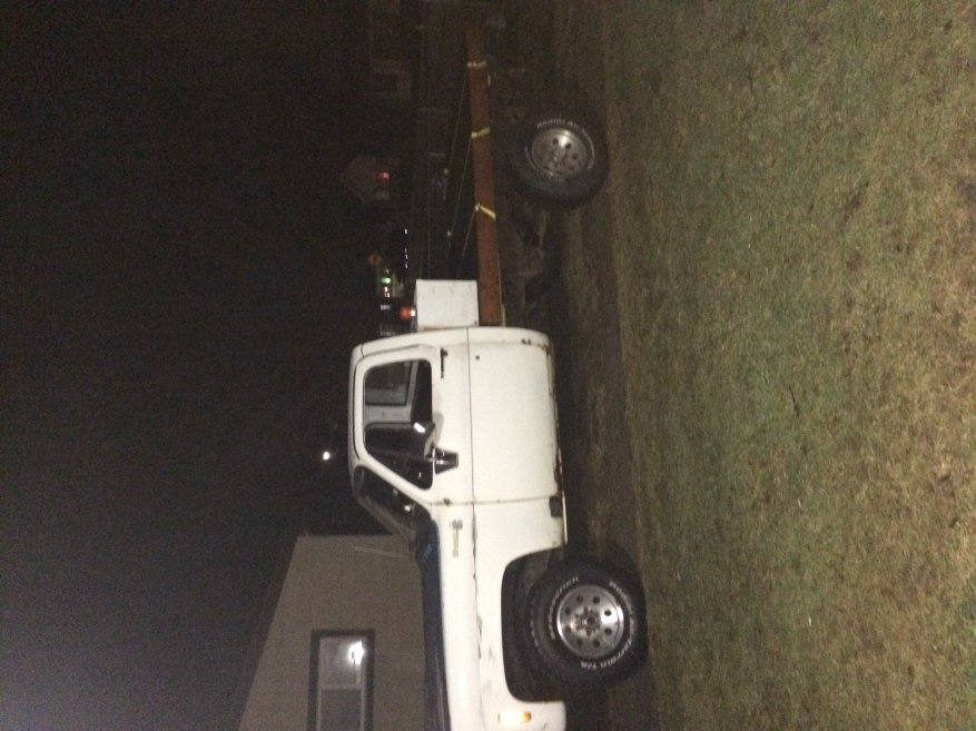

Hopefully good from here on out! Starting again on my day off tomorrow I'll will inquire if I run into some problems! Or maybe just post some truck pictures.
