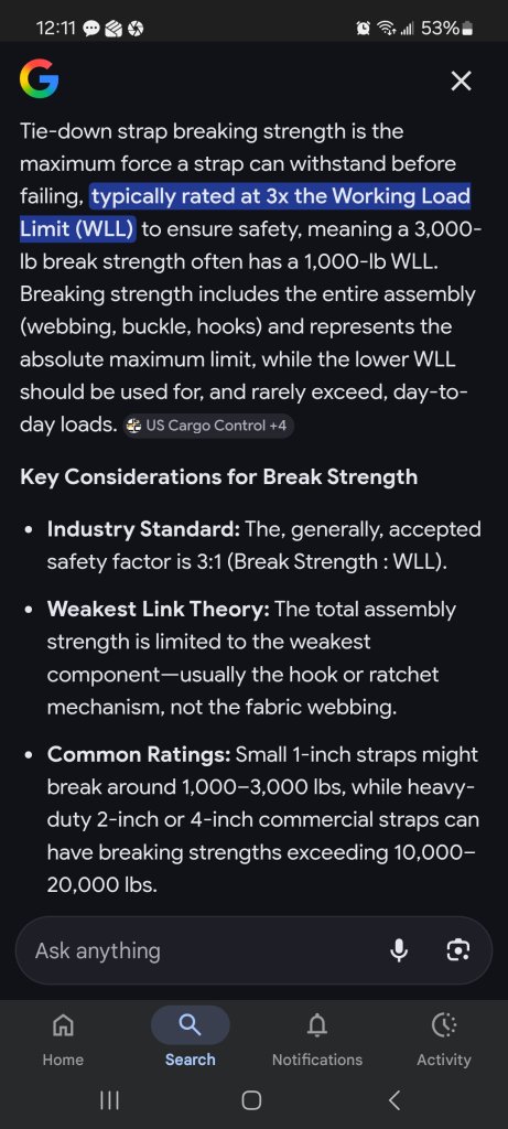

I think next time I'll use tie downs(cautiously) As for struts I won't tell you how we sometimes did them at work to beat flat rate time.(whoa!!!!,just occurred to me bind STRUT SPRINGS at installed ride height) then remove the strut cap,if it works,even better than our old cheater method.
