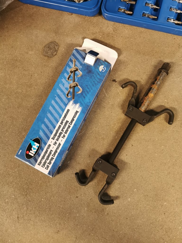

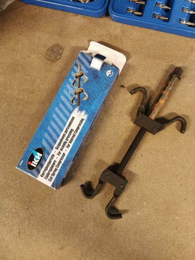

I used this. The bolt was too long, so I made a sleeve (the rusty part). Worked all right.
