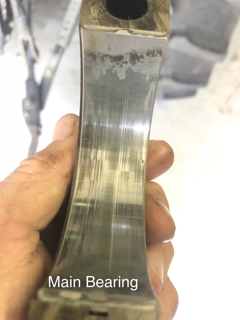

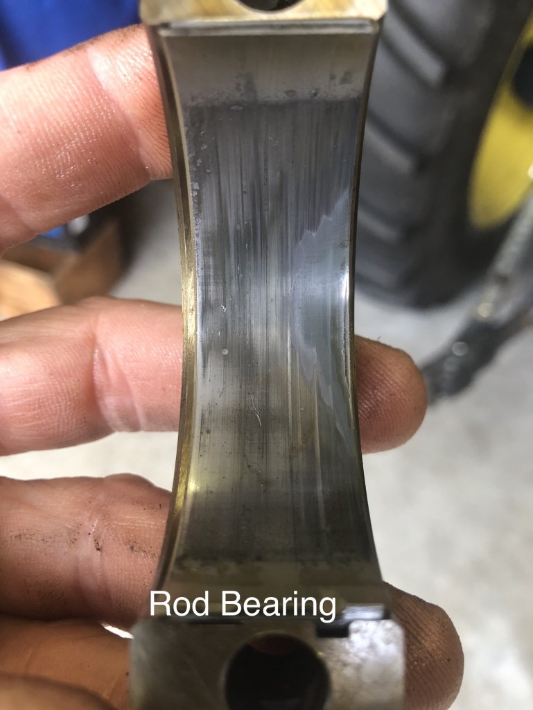

I have attached a couple of pictures of one of the main caps and rod cap bearings form a 160k mile 1993 454 I’m working on. Does this wear seem excessive. The crank appears to smooth without any grooves or distortion. These are the only 2 I have removed so far.

To me, it doesn’t look excessive for 160k miles. There’s a lot of wear but no brass(?) showing so it’s not too deep. I wonder about the odd pattern towards the side of the rod bearing though.

I don't see any copper/brass color,
Picture on right has a funny spot on the right side?

160k no wear is not excessive. How far are you going with this engine out of truck on an engine stand,or working pan off,underneath the truck? What are you trying to accomplish?

Thanks for the replies, like I said in the post where I was asking about the gaskets its been a long time since I have helped with working on motors. I have worked on my personal 4x4 trucks for 40 years. 2wd to 4wd conversion's, lifts, axle swaps, tranmission swaps and most any repair in between, but just not a lot of exposure to the wear of a engines internals. I have always watched TV shows like Powernation and all the others over the years, but putting a part in your hand is a lot different than seeing it on a screen. So thanks for your patience.
Yes the engine is on a stand and I'm taking it all the way down.

Reference wear pattern on the rod bearing.....I am saw where someone posted a picture of a bearing with similar wear and folks are saying cause could be a bent rod?

do you know the measurement ? If not, may be woth checking out, if its barely any different or the same, id ignore it i guess, but people for similar bearings suggest plastigaging because it may indicate a connecting rod that is slightly bent OR the end of the rod is not machined perfectly , having a high and low side
