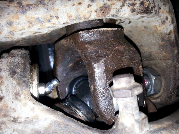

got new ball joints in. the grease zerk included for the upper comes out the bottom and is angled, but also doesn't clear the axle yokes, so does that mean i need to just plug it and it won't be greasable?

No. Put a regular nipple in and get a side grease fitting for your gun.

will it still clear with the zerk on my ujoints? it is the small female style one.
or the other option which would be a pain would be to plug it, then remove it and install the angled zerk for greasing and replug it?

If your upper ball joint is fully seated a straight small male grease nipple will clear your u joint, but is only greasable with the tires full left or right and using the gun fitting in the pic.
