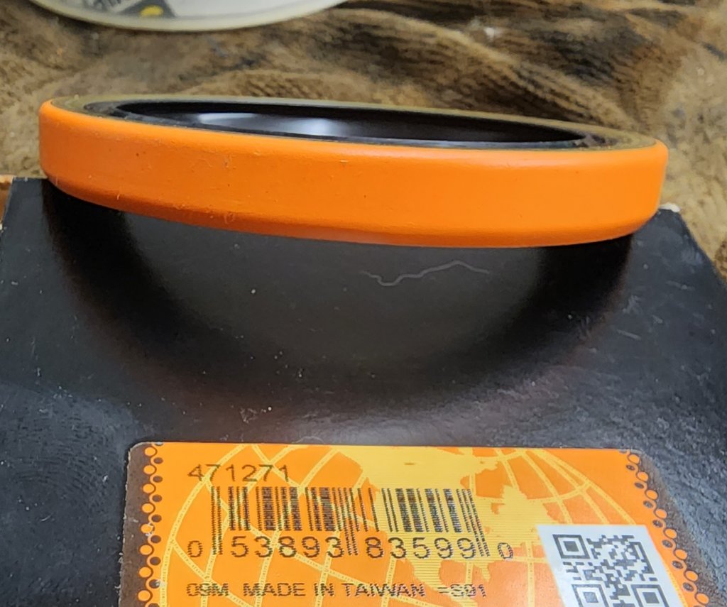

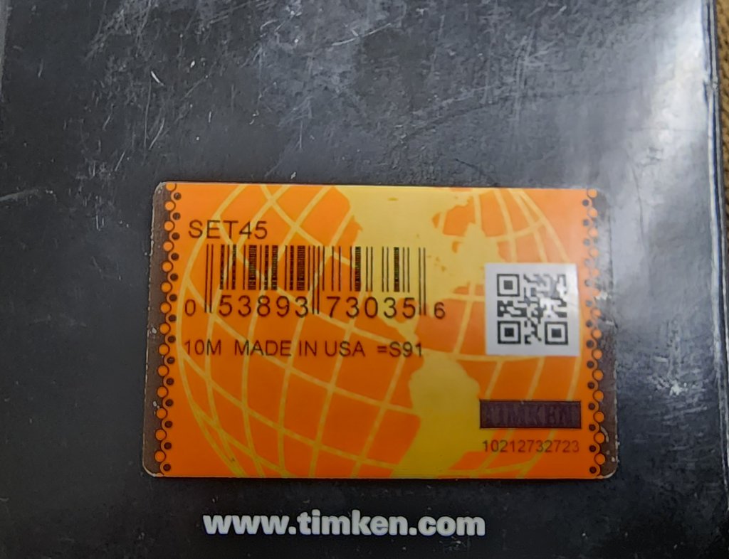

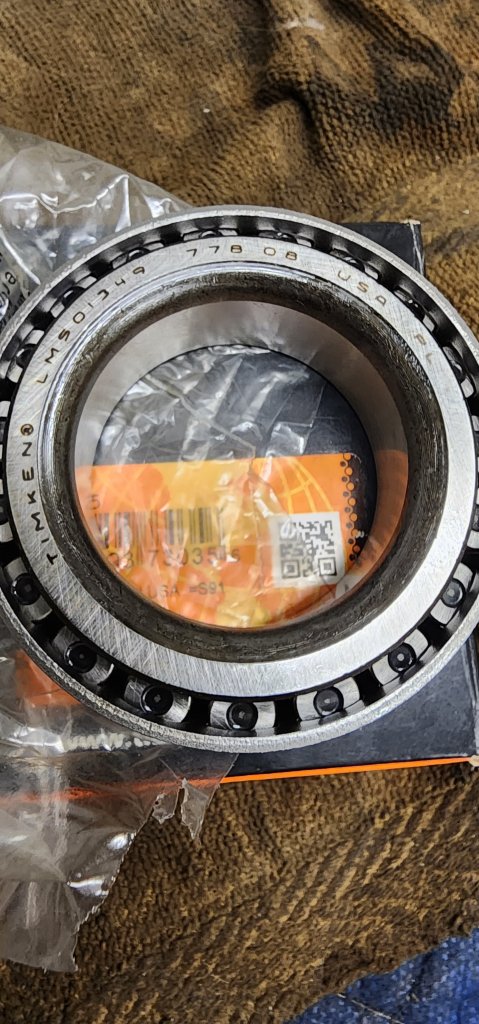

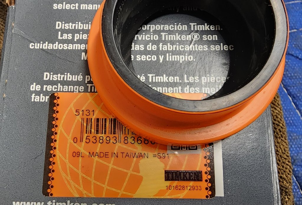

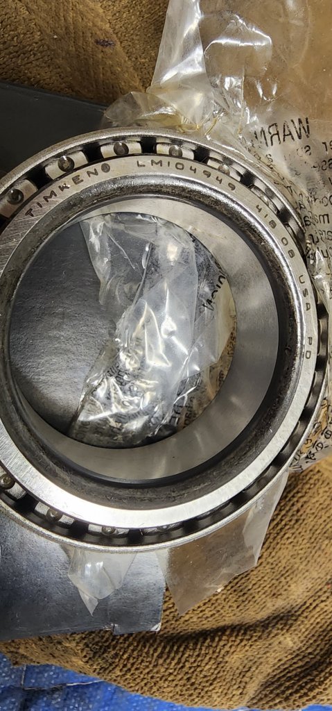

Hello @Buck69. I hope all is well.
I have been slowly working on my 1984 Chevy K10.
I have ordered all the front end bearings and seals including the carrier bearings and differential seals all from Amazon.
I ordered All Timken brand.
ALL the bearings are stamped Made in USA.
Only the seals were stamped Made in Taiwan, but they do seem to be of very high quality.
Be well and stay safe out there.
Best wishes to you and all of your loved ones always!
