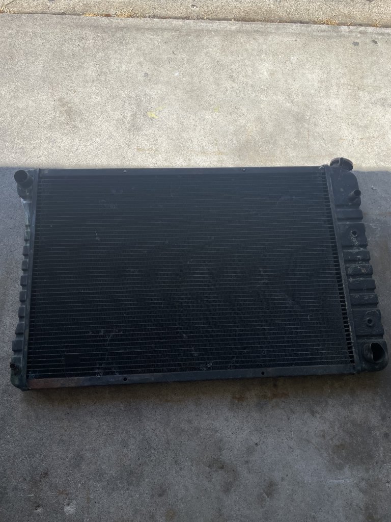

I am trying to find an aluminum radiator that is a direct fit on my 79 GMC Sierra Grande w/ 350 and manual trans. Does anyone have a Summit or Jegs part # that worked for them. Looks to be about 33”x20 1/2”

Square rads usually come in 19” or 21”. Sounds like you’re definitely a 21”, but double check measurement to be sure .
If the one NastyLSX doesn’t work out, I’ve been very happy with my Cold Case. Here is a search on their website for your year. https://www.coldcaseradiators.com/products/fitment/1979-GMC-Truck-any
The side tanks are stamped to look factory. You can paint them black to help it look stock or just leave them aluminum like I did. They come with a sacrificial rod installed too, so if you were to have a bad ground, the electrolysis would eat that instead of the radiator.
Edit- don’t order one with the “1.75” lower hose option- that hose is a unicorn and if it exists anywhere, I couldn’t find it.
Double edit- never mind the measurement, didn’t see the picture initially that you had it out of the truck.
12,010
19,105
Check out northern radiator for a copper brass unless you're dead set on going aluminum plastic, or full aluminum. Pricey, but direct fit, just have to trim the shroud a little.
Edit: The shroud has to be trimmed so it doesn't ride on the core, it's a more efficient core, so it's wider than an OEM. CR1599 is what I got for my 1981 C20.
