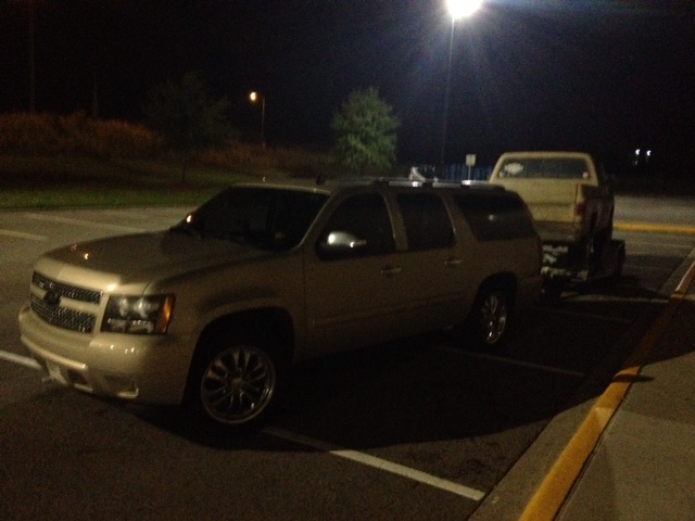

To answer your question thoroughly, the 2 battery trays are for the PPV tahoe and suburban models that the government uses. Helps run the lights and stuff. You'll know if you found a PPV if it has a 140mph speedo. I have a 2007 LTZ suburban and I can assure you this: stay away from auto ride! If you are going to tow anything at all have the transmission flushed. It's got 162,*** miles on it and we've already replaced the oil pump and both air shocks in the rear are blown. It's nice for hauling the kids around and did one hell of a job towing my newly acquired 77 K10 home on a car carrier from uhaul. It also has stabilitrak, which likes to go off at odd times, sometimes when you're sitting at a red light. Lots of electrical gremlins. If you think for any reason you might tow something heavy go with a 2500 LT model.
