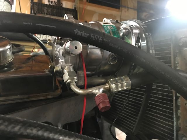

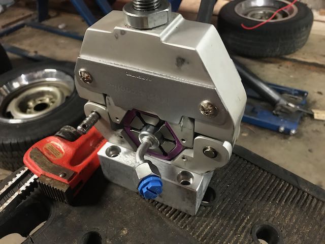

I was just going to order a kit like this.
I need to do a few hoses on my K25 when I do the engine swap and it changes from the A6 compressor to the modern Sanden compressor. I Also am missing a bunch of hoses for my 67 Buick Riviera and will probably need to make them since no one seems to make them anymore.
As a heads up, I own that exact crimper. It will hold A/C pressure, I use it frequently to make custom hoses and ends for restomod cars that I build all the time.
It WILL NOT hold hydraulic pressure. I loaned it to a friend who tried to make power steering hoses. I warned him after he did it. They worked for a bit, and while turning wheels at a stop, in a parking lot, a fitting popped and caused a small, extinguishable, fire underhood when the PS fluid hit the hot exhaust.
I know you spoke of AC hoses, it'll work great for that (Speedway sells a generic fitting kit, and hoses at good prices, too.)
But, for anything hydraulic, your mileage may vary, but I wouldn't go cheap on transporting flammable oil around a hot engine bay. Pay the nice people at Parker and sleep well.
