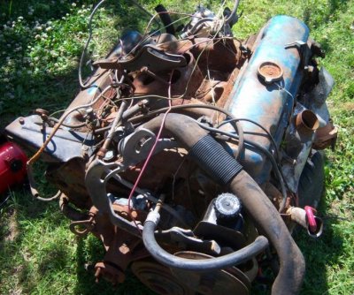

Hell yeah, crank that bitch up. I wanna see some iron cook to brand new condition. This is why I got that 10/40 160 amp charger. Its a heavy duty and I hope to run it at 40amps instead of 10amps. 4x the cooking power. And I hope it will unseize a Pancho 400 that sat in a pasture uncovered for over 10 years.

Ahh man !!! I was gonna sell it to you cheap as it sits complete, less the brackets that were taken off. Price gotta go up if I work on it. To many projects so little time !!!

Thinking about using some steel rods for electrodes
Kinda hard maneuvering the copper coil in without touching the manifold now :(

I've seen people use rebar, as long as it sticks up out of the water, you dont want your wires in there it will oxidize the copper wires too quickly.
Use anything you can get, just no alluminum, cuz it will disappear.

I need to get me a 55 gal drum next time I do this though
The little trash can im using sucks

What would happen if you use a metal trash can and just hook you ground up to the trash can?! Like one of those galvanized ones.

If you use a metal trash can I wouldnt use a galvenized one, not sure how the zinc would react. Trash cans like that arent really designed to be filled with liquid and may leak, but a 20 gallon steel drum would be ideal for smaller projects. You would have to insulate the part, let's say a cylinder head, from the bottom of the drum with a piece of wood or thick rubber mat. If the part you're working on, which is connected to one lead, comes in direct contact with the metal drum or rebar or whatever you're using, you get the nice fireworks display MBP was talking about, or an overheated/burned-out battery charger.
