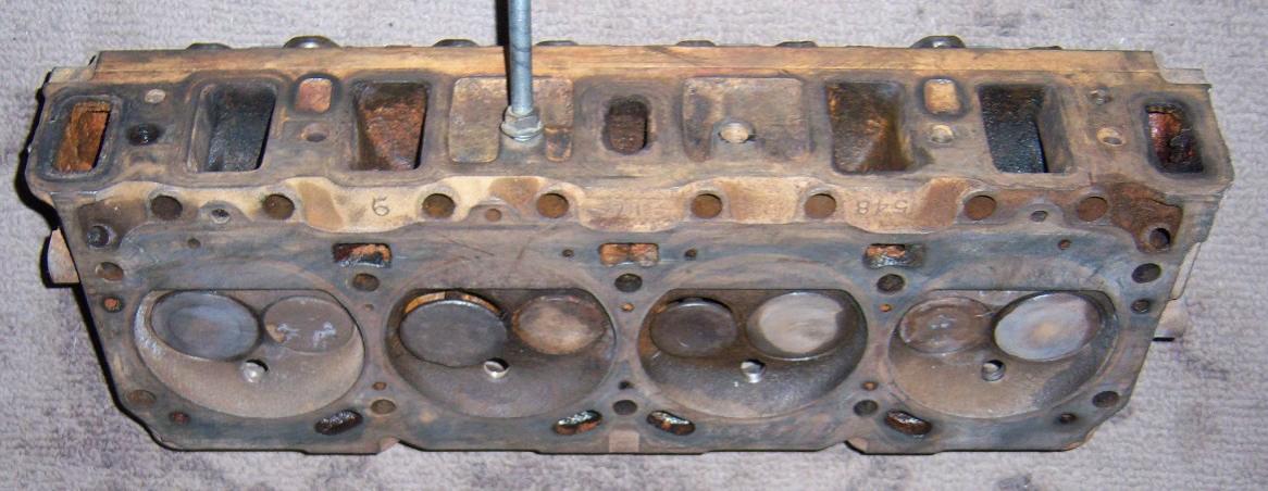

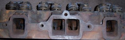

Here is another one after its just about completely dry.

that's just plain awesome seeing as what you started with...
Yes, its an amaziing process, and I think I'm about to get it dialed in !!!

I see it, and still don't believe it, lol!!!!!! :High 5:

I'm sitting here touching and looking at it in person, and I don't beleive it.
It looks even better than in pics, and looks even better now that its dried. My male husky keeps sniffing it. I done warned him, I see him hike his damn leg on that thing, no treats for a week and he is on restriction for a week with no going out in the front yard with me.

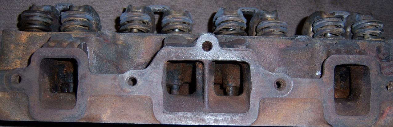

Here is another shot. Look how it cleaned the ports even. I can tell I want to run it one more time with clean electrolyte to get cleaned deeper. And this time, I am going to go ahead and pull the valves and rocker arms off before I do it. That way all the port will be open with easy access to the steel, and the process will concentrate on the head ports insted the parts I am not going to use anyway. Most of those valves are pitted. I'll have to buy new valves to use these heads. Which is fine. Since the bigger valves cost the same as the smaller ones, then the only differance it paying the machinist to machine the head for bigger valves. I'm going with stainless hardened exhaust seats anyway due to unleaded fuel.

I was just going top mention, it still looks a little crusty in where the valves are. ****, if you pull them out and sit it facing valve opening facing up int he water, it should cook that **** right out of there. :High 5:
Also those end water jackets still look a littel crusty too. I guess the fire department wasn;t needed last night? lol

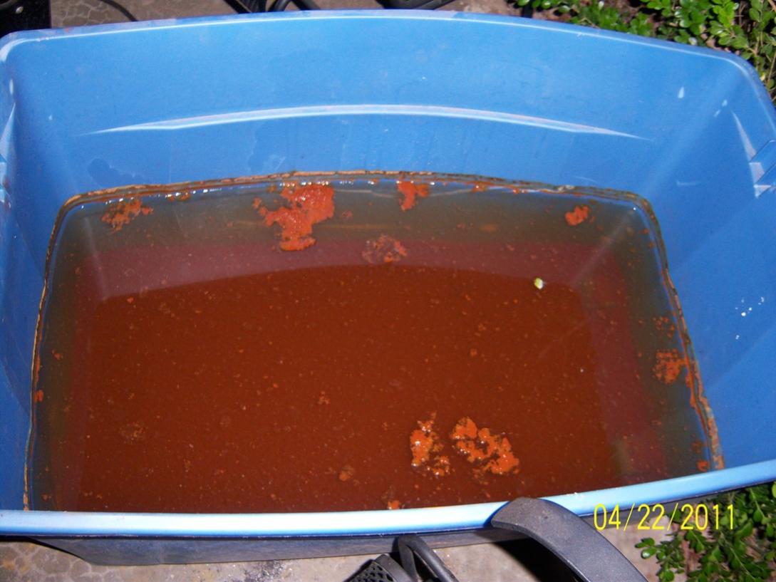

Here is the steel and what it looks like after I was done last night, and the tub. There is rusty mud covering the entire bottom of the tub at least an 1/8in thick probably closer to 1/4. That took alot of rust off that head. Hard to beleive there was that much rust on it. I'm still amazed and impressed with the process.

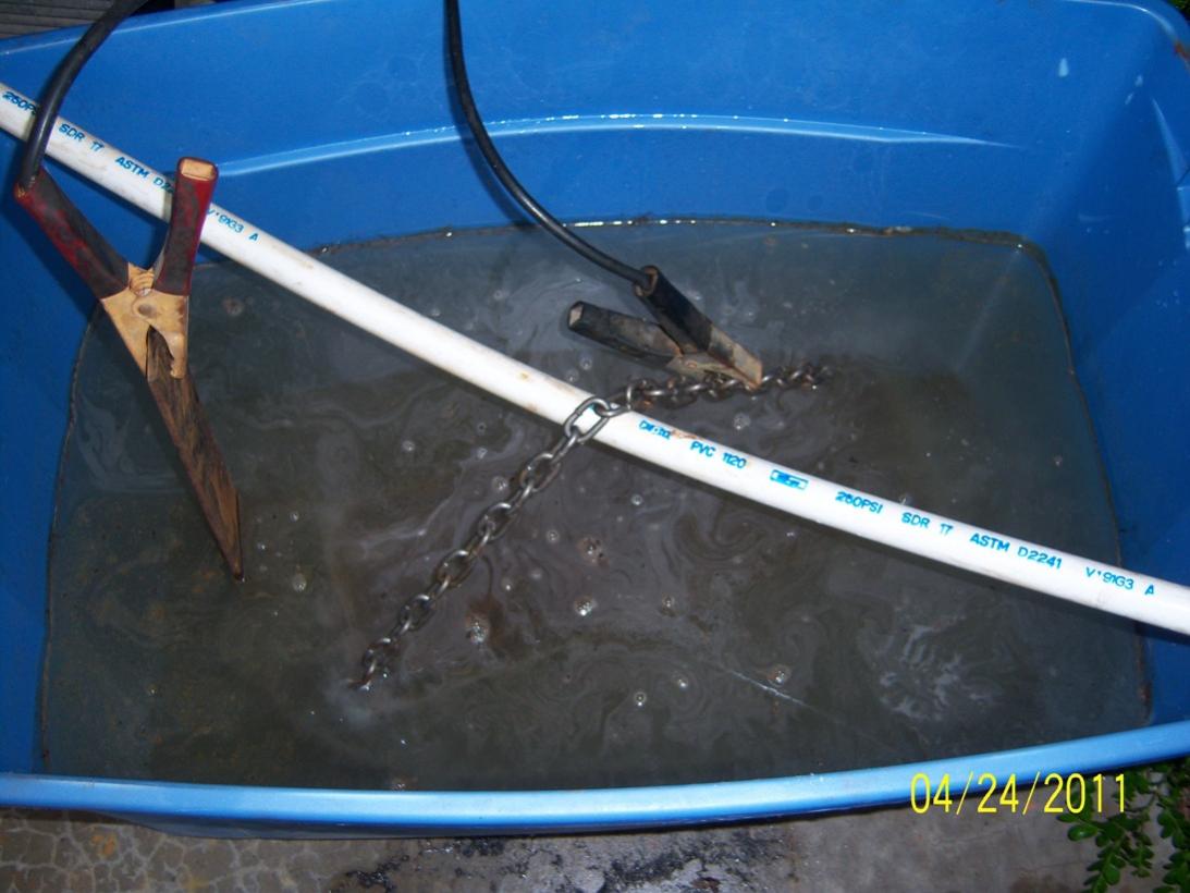

So here is what is different this time. Notice the chain. I am using a chain instead of a bolt in the head. I idea here, is that I have 2 connections to the head being cleaned instead of 1. Also, 1 on each end, instead of 1 in the center. Also notice the PVC pipe and its tight flexing. The PVC pipe is serving 2 purposes. #1, to hold the chain out of the water, so I don't have the charger lead in the water. #2 and most important, is the PVC is working as a spring putting tension on the chain, to keep the links tightly held to each other for a good connection between all the links. The weight of the head itself is holding the tension on the links pulling it down and flexing the PVC.

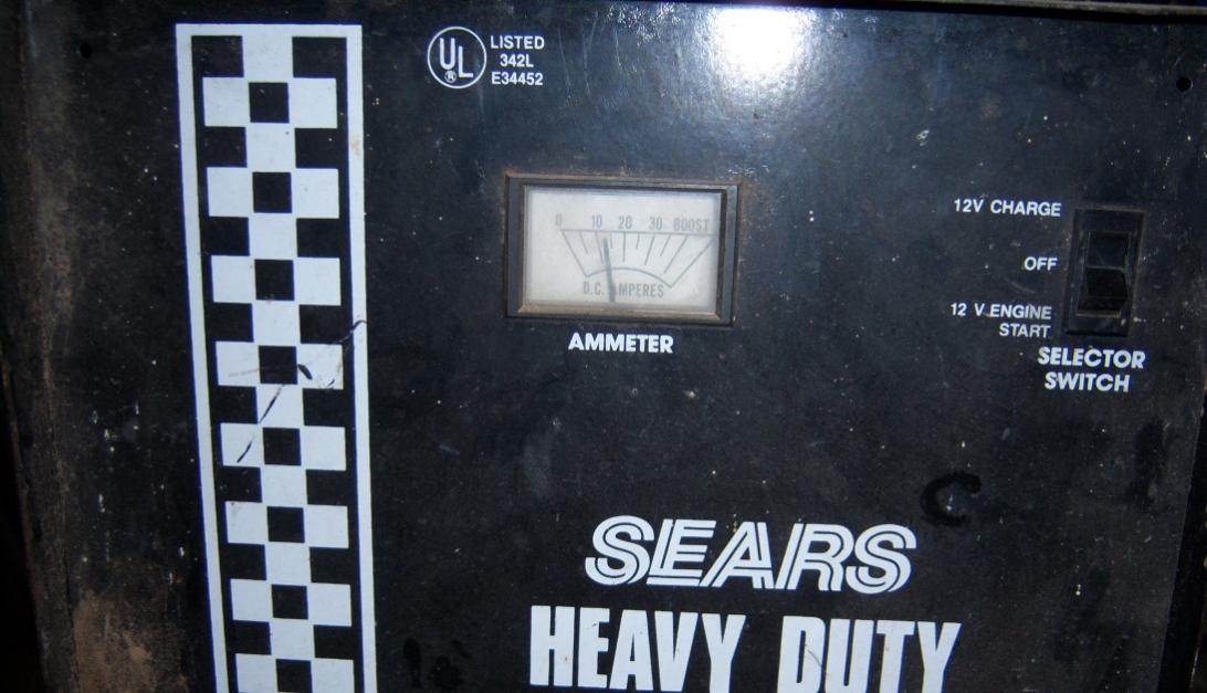

Obviously my connection is good. Again, like the last head with the bolt and the same ring, the amp guage is just as high with the chain as it was with the bolt. :waytogo:

Just a little update using the chain method. The process has ran just over 2hrs now, and I really am not seeing any difference than using the single bolt method. Seems to be pretty much identical as far as progress by compaing the foam the color of the water and the bubbles. Process is working good, just not with the results I was expecting or hopnig for.
