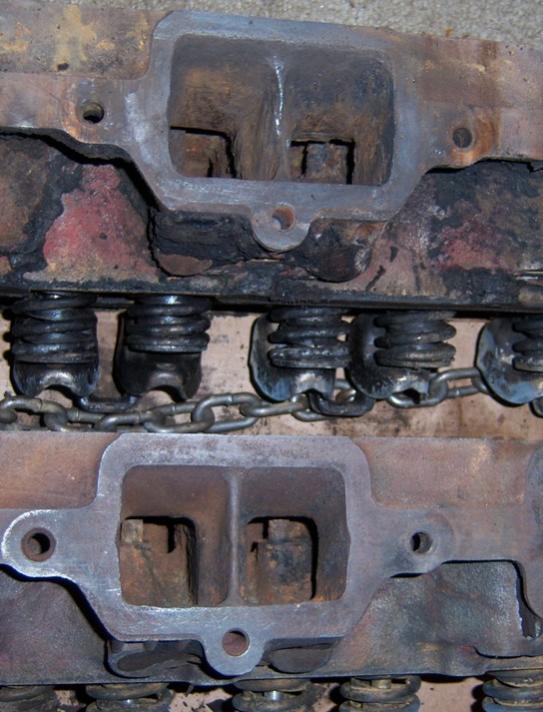

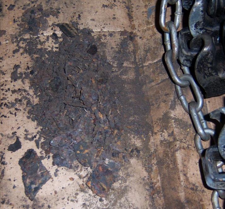

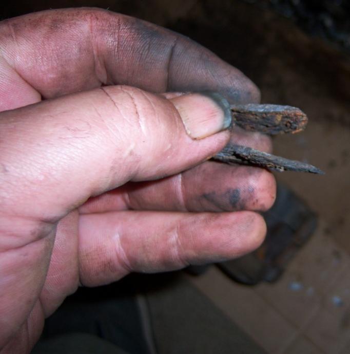

Here are some pics of what I got out of that bad head AFTER running the Electolysis for 8 hours. Look at the 2 center exhaust ports and all the rust and decayed iron I got out of just those 2 ports. Those ports basically have ported themselves. LOL. They are now much bigger than OEM. Also notice the chunk missing in the webbing that seperates the 2 ports. I'd have like to have used these C heads since they are said to be the best flowing. But, looking at a flow chart, the E heads flow almost just as well, and the advantage to the E heads, is 3 cc less combustion chambers making the compression ratio a bit higher. So I'll likely sell this one good C head and use my E heads instead.
