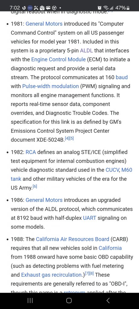

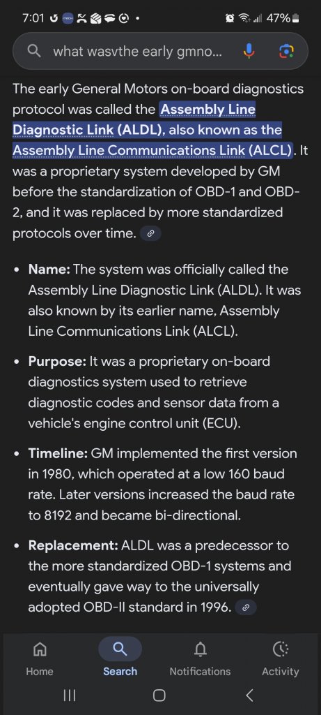

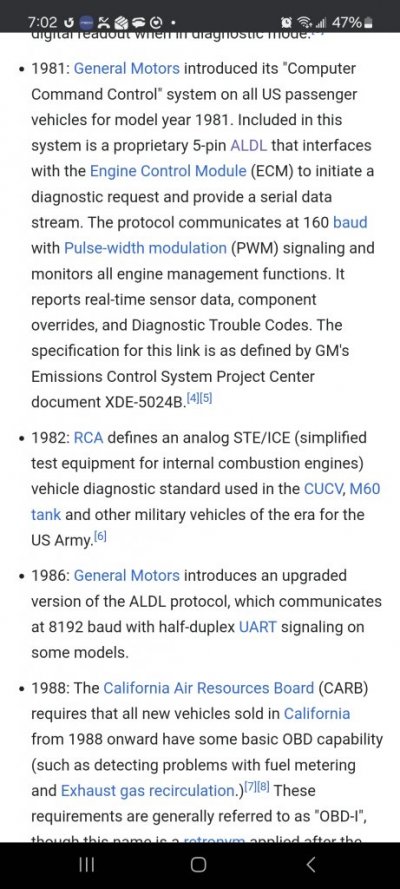

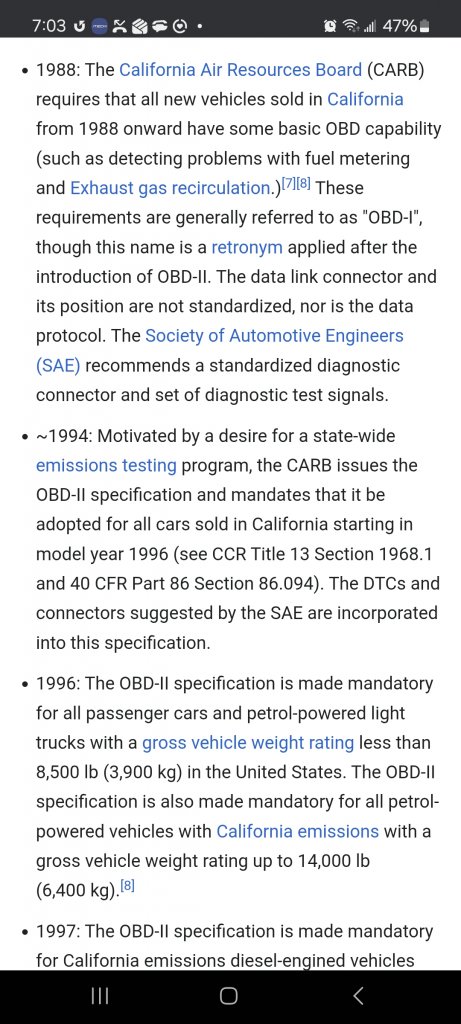

OBD1 didn't come about until 1988 and that was for California. Gm got OBD1.5 in 94 and 95 prior to that it was different versions of GM ALDL. OBD2 96 and later.
