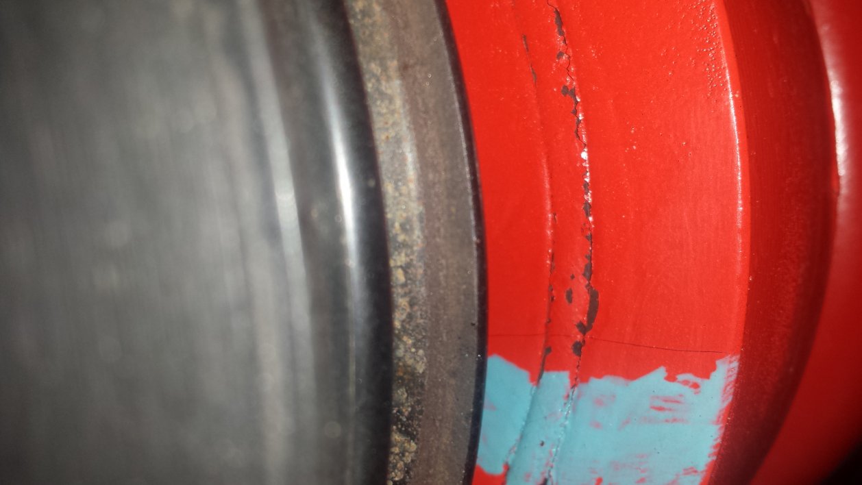

I have a pulsating vibration that gets noticeable around 60 or 2800 rpm. but hardly noticeable in neutral and vibrates right before the shift and is holding on to second for a long time. I have replaced the u joints and carrier bearing. I rebuild the 454 about 600 miles ago and when i got it running the vibration got much worse than before. My fuel economy was good though 10-12 ish I unbolted the torque converter and turned it then bolted back together the vibration got better for a little bit. after about 100 mile the vibration came back and is getting worse. i have brought it to 2 transmission and both have told be its one of three things 1. harmonic balancer 2 fly wheel or 3 torque converter. I marked the balancer and cant see that its moved but i can see a vertical black line on it. i unbolted the tc and started it up and the vibration became very noticeable. on top of all this as the vibration has getting worse so has my gas mileage which is why i was leaning towards the tc but now that i unbolted it and the vibration got worse. Maybe my fuel economy is unrelated but I'm lost as **** right now and moving 1200 miles in 2 weeks and need my truck bad. now im down to 6mpg.
