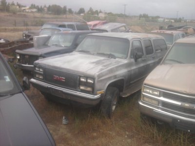

I have a set of the power mirrors and I hate them they just look stupid anyone interested in them. I have the special side windows with the blacked out part also.
