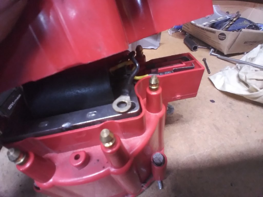

Just for fun did the issue of properly grounding the coil come up? on some coils the ground is just made by one of the top screws passing thru the coil ground to the body.
There is a ground wire from the body to the back of the head, noting off the distributor...

This is what caused me to junk mine

Mine made a lousy connection. hole too big, screw too small and poor connection.
