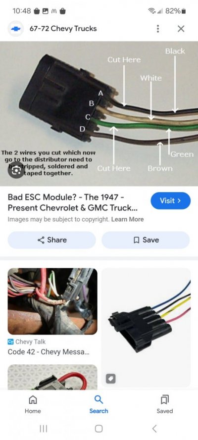

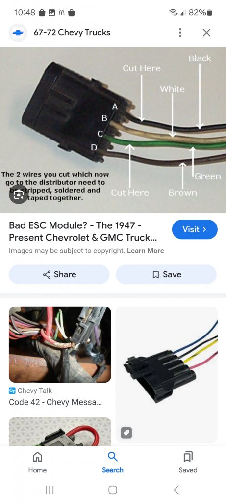

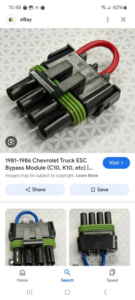

86 should have knock sensor ignition. If the controller goes bad it will create a no spark condition super easy to check with just a piece of wire. Unplug the 4 wire connector at the distributor. Make a jumper wire to jump terminals A and C I believe green and black? I'll see if I can verify and post back anyway the jumper will bypass the control unit. Then you can run with it jumper while you source a control unit,or not. Some people ate perfectly happy with no knock sensor some are not. You can actually read about @SirRobyn0 year long adventure trying to run no knock sensor. I was not happy without mine. I'll double check bypass procedure BRB. Yep it's A and C Black and Green pics for illustration. You can just use a piece of wire for testing.
