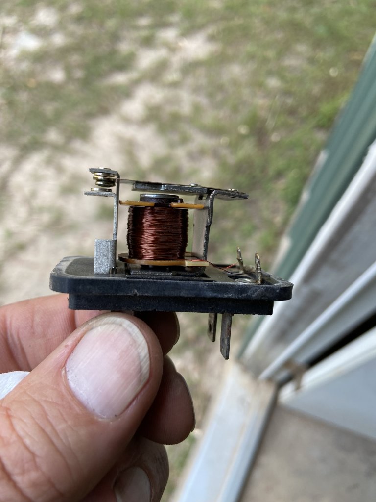

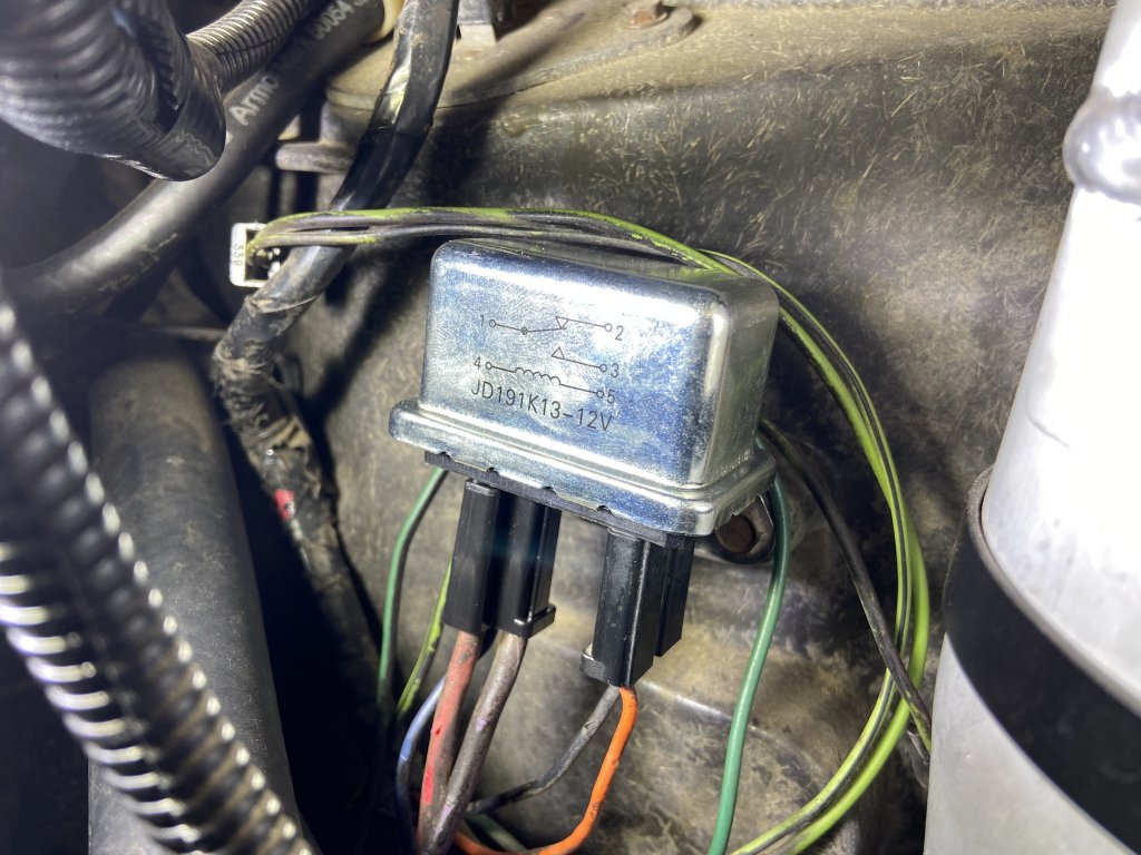

Blower motor quit working on high. I found that the 3 pin connector going to the blower motor relay had melted. I replaced the relay and the connector, fan now works fine. I did open the old relay and found that it had a bad connection on the coil.
