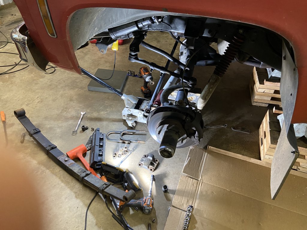

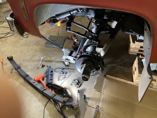

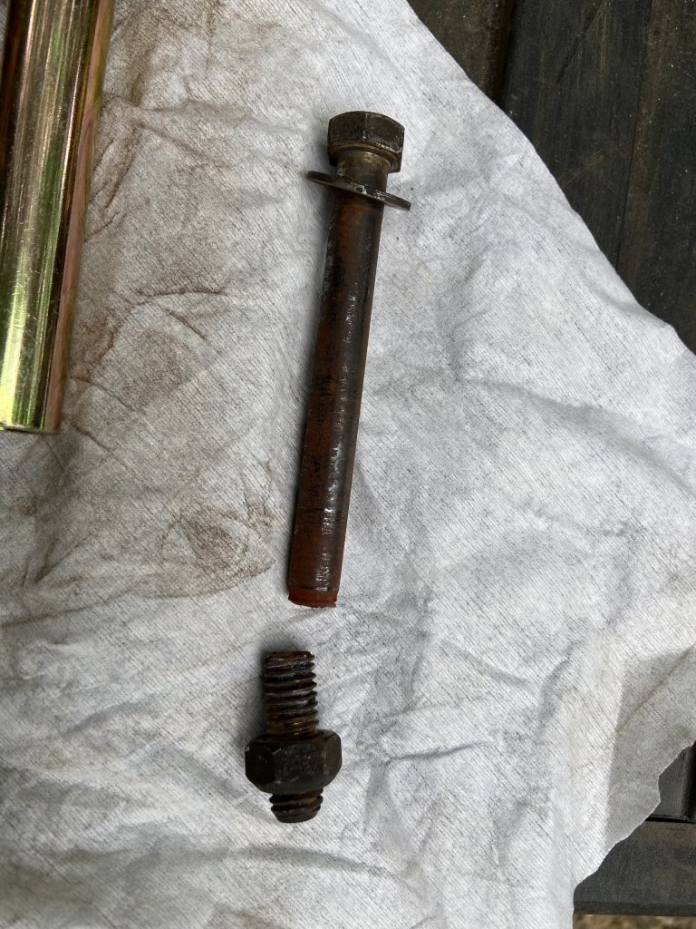

So I have been experiencing intermittent death wobble. The front axle has been rebuilt, new steering gear, alignment was done right after axle rebuild and what had not been replaced is leaf spring bushings. Keep in mind that the polyurethane bushings were installed over 22 years ago when the lift was installed. So I figured it was time for bushings since everything else has been replaced. While removing the front springs I found that both frame mount bolts for the front shackles were broken. Now with new bolts and bushings i have not experienced any death wobble. Hope this is the end of it.

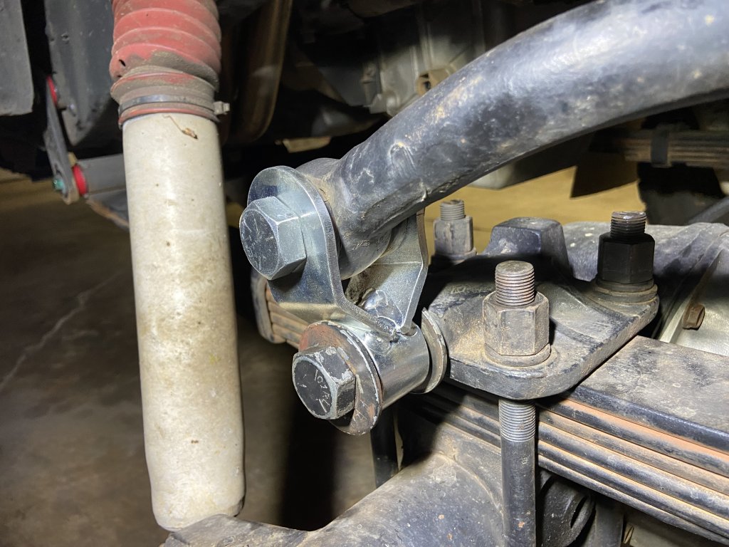

Installed a set of sway bar links. Never liked Goethe sway was attached from the factory. To me it put the front suspension in a bind.
so were the front spring/rear bolts? I've got a bunch of play and those are the only 2 bushings I haven't replaced. Just checking my thoughts.

Yes. Front spring, rear bolts. One each side was broken. BTW. Still experiencing occasional minor death wobble. May need to take it in for another alignment.
