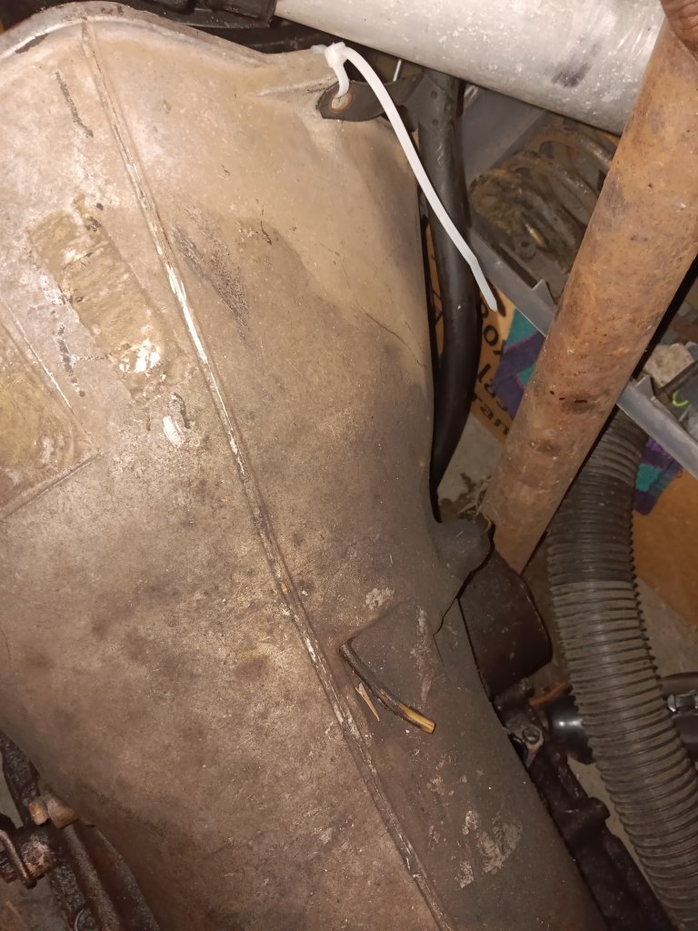

Where about on the bellhousing? I’ll check tomorrow when I put the reducers on and put some side pipes on it for now, I don’t know much about transmissions but this one is thrown me off the edge so far

On the passenger side up high. Crappy spot kinda. Be careful, I think they are white plastic unless someone has changed it. I have an R4 on the shop floor. I'll try to catch a shot.

Not quite as high as I remember lol

Somewhat similar to a 400, I had a th400 in my c30 that that tube had broken off. I can check it. If that’s clogged would it cause the trans issue? On the th400 previous owner said it would deep fluid out the dipstick tube.

It was a while back but if I remember correctly he was having strange fill issues like what your having. Makes sense if it can't vent.

Have you verified the vent is clear?

I saw a little metal tube up top angled towards the rear of the vehicle, whag I could see of it was clean. The trans isn’t all grimy, I mean it’s clean. The pan looks aftermartket or something in my opinion. It’s got sort of a yellowish hint to it and I don’t think it’s steel. It has a crater near the front

Carefully put a vacuum hose on it and don't blow see if you can suck air through it. If it's plugged up it could explain allot.
