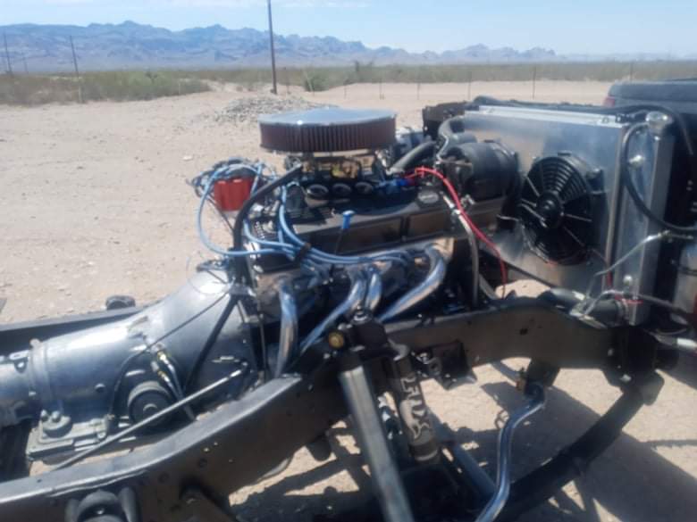

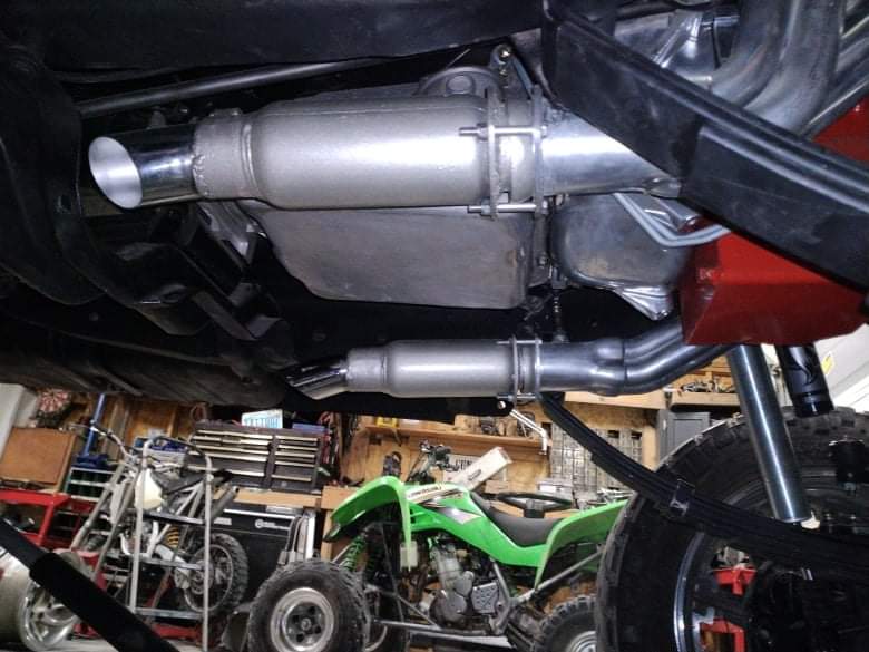

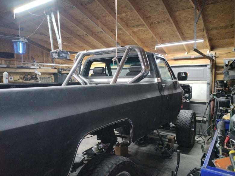

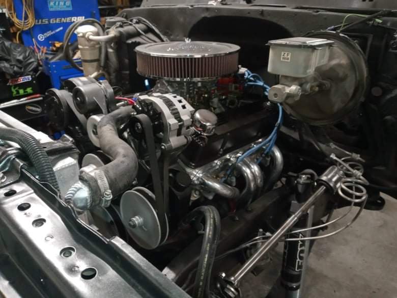

Ok so this did answer a few questions, like what that deelybobber is on firewall...and that with new $900 harness that has bubkiss for it.....ill never waste money on a named wire harness again......absolute waste of money.....sorry i should not get started on that topic. Anyways ill give you a breakdown of my setup....ill try to make it short. Ok its an 1981 body, single cab longbed 4wd k10 w/ 3/4 running gear from 1984 k20. Originally a 305 w/esc and i assume a th350 (3spd.) Now has blueprint 383, w/ built 700r4, 89 column (4spd) those are important details that i never know til its to late. So here is where im stumped, oh and its a 2500 stall. So the trans man, added a lockup in trans for the 4 pin plug, it has a +, -, or ground i believe ( ill snap pics and add later) i bought a 4 pin pigtail, but think it only had 3 wires.....so my first question is if not wanting to be responsible for flipping a switch ( i may forget its on or ? ) what would i wire the wires from 4 pin pigtail to ? And let confuse you and back up a bit, so the original setup (81, 305, th350) had a vacuum deelybobber like yours and also had a brake and clutch pressure pin near brake pedal, but somehow was also wired into a small box up on left side back of steering column frame called by pt.# tcc lockup relay, with doubled wire colors that i can only assume by what wires i could find of original harness go to brake, clutch switches and splice into transfer case wiring and possibly cruise control. Thats when i started getting confused and the dumb/expensive harness does not provision nor give any instructions, and the actual wiring diagrams all 20 something of same components all are confusing or do not detail any tcc relay or where it would be wired to.......... so with all this ive written, im sure ive only confused you more then you wanted....lol. any feedback would be appreciated and will give more precise information and pics next time i get a chance....thank you my friend.....sending pics of what i may have on phone, but probably not what you need for reference
