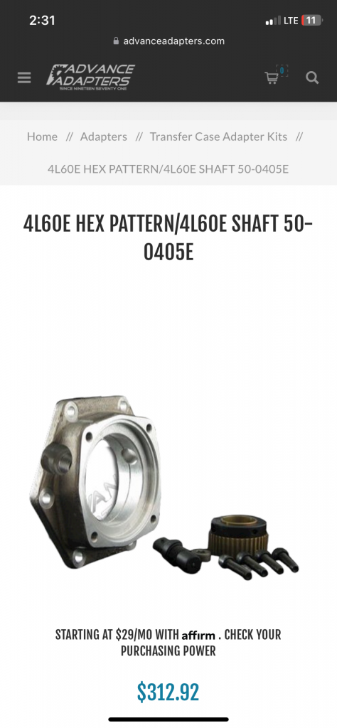

I believe what you'll need to do in order for this to all work out is, you will need the speedo cable off the back of the trans with that ORD adapter or what have you so your speedo will at least work when in high range. (The instrument panel)
You want the VSS coming from the back of the transfer case, so the PCM can shift the transmission if youre in high or low range on the T case.
Thats what lego was concerned about and i believe there was a misunderstanding

Here you go.

Has anyone not looked at this adapter? It goes between the 4l60e and 208. And the speedo cable stays in its original location in the 208. I will be using the factory pcm. I do not see myself using 4 low but would be nice id everything worked. I absolutely do need 4 high and 2 high. Both my tuner and tech support didnt see any issues but they were brief as stated before i’d like to avoid any headaches. Would this not work and why? Has anyone gone this route with a stock pcm?
If you are picking the VSS signal off before the T-case, then it won't matter if you are in 4-lo or 4-hi. The shift schedule is based on vehicle speed and throttle position, and that won't change if you are in 4-hi or 4-lo based on that signal location. You can still adjust your shift points and things like engine braking with the 4-lo signal, but the shift strategy will be almost identical in the 4-lo table to start with.
Can you dumb this down for me? Are you saying 4 high (and 2 high) will behave like 4 low? Or are you saying 4 low will not shift correctly? I thought with the use of a switch, i could tell the pcm “hey i am in 4 low” and it would use 4 low shift tables?

The VSS in the trans (before the Tcase) will read the same speed regardless of the T-case being in high or low. The ECM(PCM) uses VSS for shift tables. I don't think you can use a switch to adjust that.
